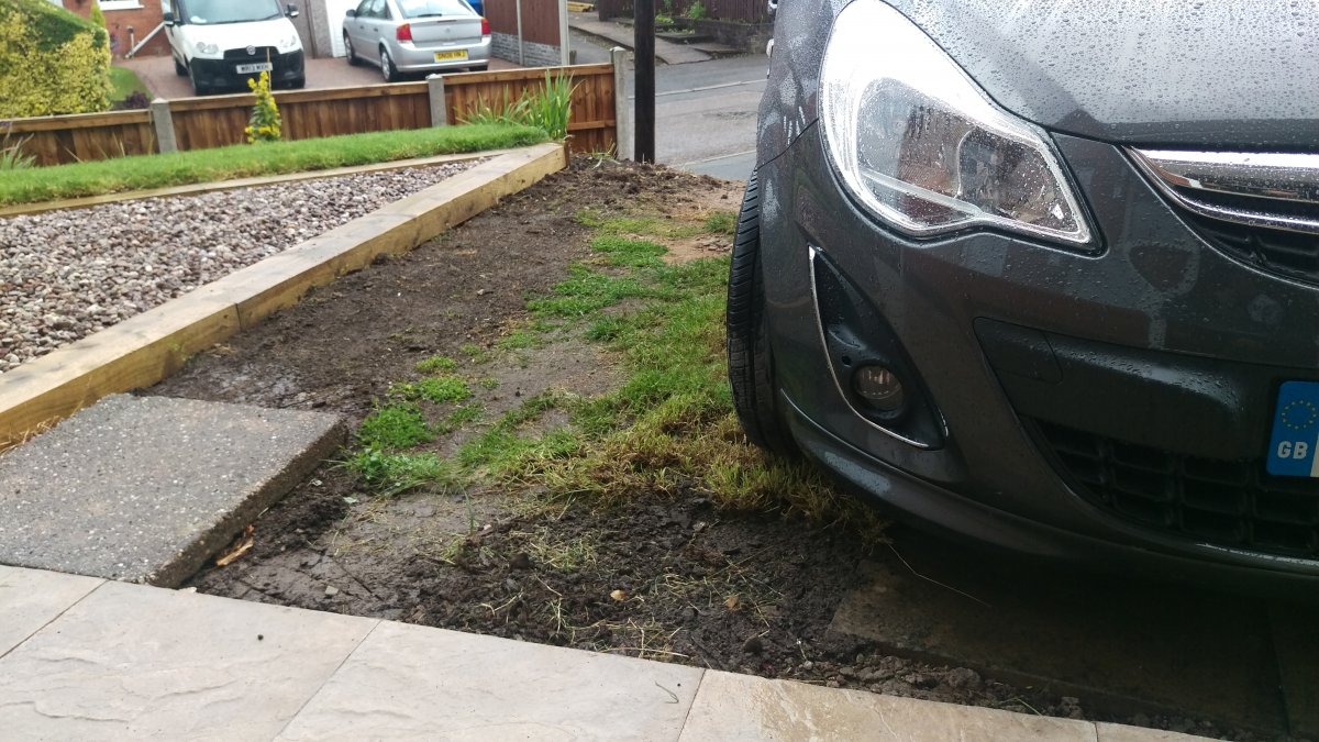

I have a steep incline leading up to a flat grass/mud area where I park my car. This is fine in summer but in winter the muddy area is not suitable. The steep section is concrete so I was going to let that be for now. So just after ideas to replace this area. I was thinking gravel with the honeycomb trays to help retain it.
Open to suggestions.
Cheers crystal clear. Was thinking of just putting the honeycomb where the tyres will run to save on cost. But still gravel the whole area. Might also need to add some edging to create a lip where the gravel would meet the concrete slope. Will take a better pic tomorrow.

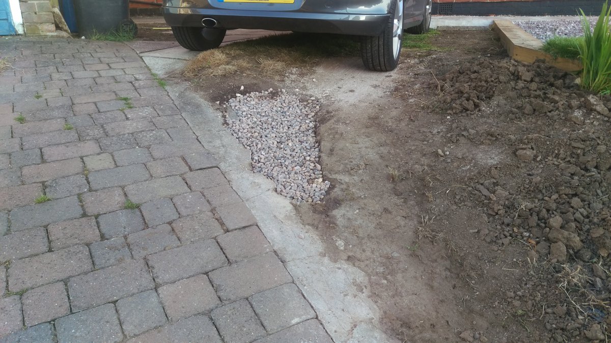

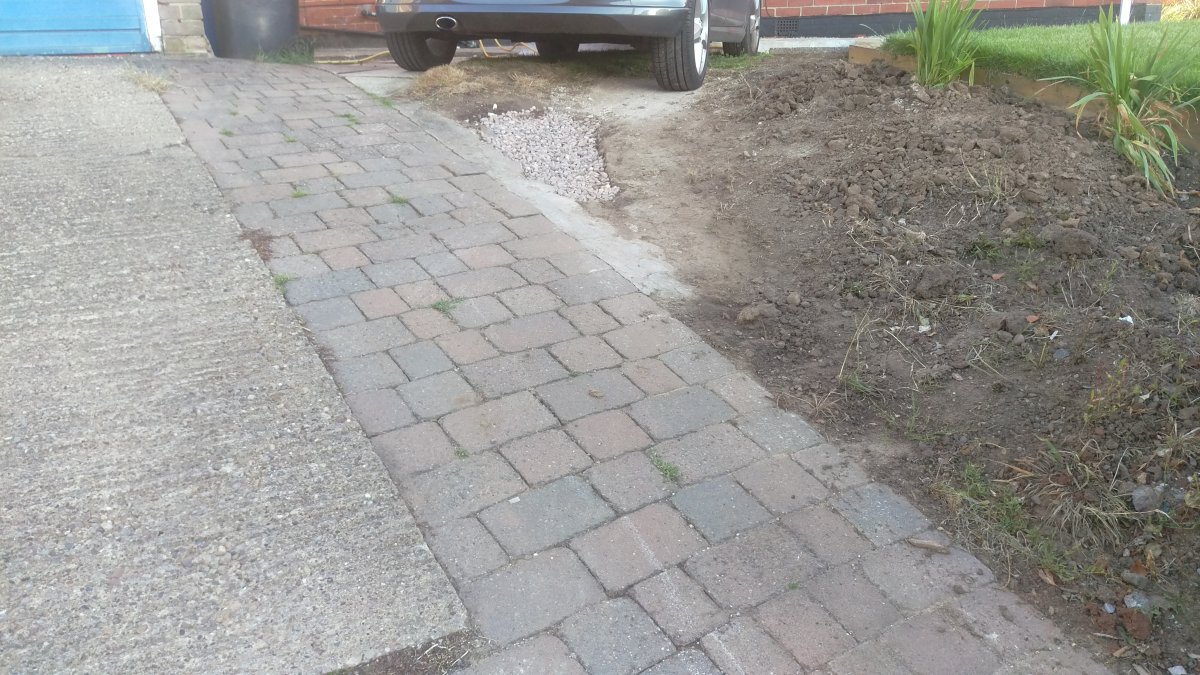

I have attached a few more pics of the area, particularly the join between the steep section and the mud/grass.
At the weekend I removed a very muddy section and replaced with 150mm of sub base and some decorative gravel as a temporary fix.
Had a change of heart.
Think I am going to use some spare 600x600 slabs to create 2 lines of slabs for the car to drive on. Blending them into the slope of the existing drive. I will then gravel in between and at the sides.
Does this plan sound okay?

I think you're combining too mant finishes on the drive. It looks like you have a concrete drive, a block pavier pathway beside it, beige slabs at the front of the car plus an area that's got chips. Adding different slabs will make it look a mish-mash. Could you acquire matching paviers?
If you do go with slabs beware you can't simply lay them to two directions of fall without cutting them diagonally.
Thanks for the reply Alan.
Yes unfortunately it is a bit mismatch. Although no bark is present. I was hoping that the gravel and slabs would tie in with the existing gravel and slabs at the top of the garden.
The current sloped section of driveway is pretty old and was there when we moved in. The concrete section joins to next doors driveway too.
