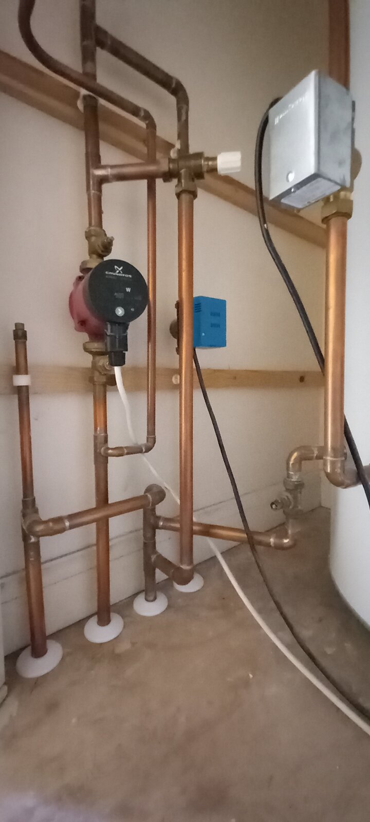

Hello Everyone
After picking up valuable advice from this forum over the years it is now time to post my first question...
I would like to install a magnetic filter to my system, the heat only boiler is installed in the kitchen, the gap between the top of the boiler & the ceiling is tight so I am looking to install the filter in the airing cupboard, I have attached a picture showing the set up. I understand to get the best results you need the filter on the return before the boiler but I am going to have to resort to plan B. I can identify some of the pipes in the airing cupboard but not all & I am looking for guidance on the best location for the filter, I have 4 pipes within the airing cupboard going from left to right:
Pipe 1 - unsure but marked up with a B so heading back to the boiler?
Pipe 2 - flow through pump & motorised valve supplying the HW tank
Pipe 3 - return from HW tank & bypass valve (I think), also linked to pipe 1
Pipe 4 - flow through motorised valve supplying the CH
It is pipes 1 & 3 that I am unsure about, as they are linked but both pass through the airing cupboard floor & disappear off. Any guidance on these 2 pipes & the relationship between them would be greatly appreciated as would any suggestions on the best location for the filter?
Regarding installing the filter (Magna Pro 2) I note that some installers have wrapped the olives with PTFE tape & the installation manual states to use jointing compound, any thoughts on the best method of sealing or should the olives be left to do the job without anything being added?
Thanks in advance
Andrew

Looks like an S Plan -
From the left - Pipe 1 looks like the main return to the boilerr, that has the manual valve on it yes. Pipe 3 looks like the return from the cylinder via the lockshield and the pipe up through the floor into that is the return from the CH, the HW tees into the return and is the last connection on the main return pipe to the boiler, that avoids reverse circulation.
Pipe 2 up into the pump would be the main flow from the boiler. If all above is correct then pipe 4 would be the main CH flow controlled by the 2 port valve. Can you not gauge where the pipes go through the floor and where they exit out the ceiling below and into the boiler to confirm?
If that is all the case then the filter can go on that horizontal section of return pipe before the reducing tee with the vertical air vent.

Hi Madrab
Thanks for the detailed response.
I had a basic understand of pipes 1 - 4 & your explanation has confirmed this for me.
The tank is located in the airing cupboard on the 1st floor in the centre of the house, once the pipework leaves the airing cupboard it disappears out of view into the bulkhead above the stairs & then into the ceiling/wall voids, the boiler is located on the far wall of the kitchen which is a distance away from the airing cupboard so I am unable to gauge which pipe is which.
I have measured between the two 22mm elbows on the horizontal section of pipe & I only have around 130mm so would have to use the Magna Micro or similar? Which cleaners do you favour?
I understand that these units have to be installed in the vertical position, as my proposed installation pipe is horizontal are you able to rotate the valves enabling the canister to be in the vertical position?
By installing in this location all the return water from the HW & CH will be filtered?
Most of them you can, yes.
If the installers have followed standards and that tee from the cylinder is the last on the return then that horizontal and vertical heading left and down should be the main return back to the boiler, so yes.

You reference a metal filter is your preference, as I only have 130mm between the 22mm elbows on the horizontal pipe many filters are too big, you referenced a TF1 as being a good piece of kit, after researching I found the FERNOX 62248 TF1 OMEGA FILTER SLIP SOCKET CONNECTION only requires a pipe cut out of 70mm, is this the filter you were referencing?
Yup, and you don't really need to use 2 valves, just the system side one.
