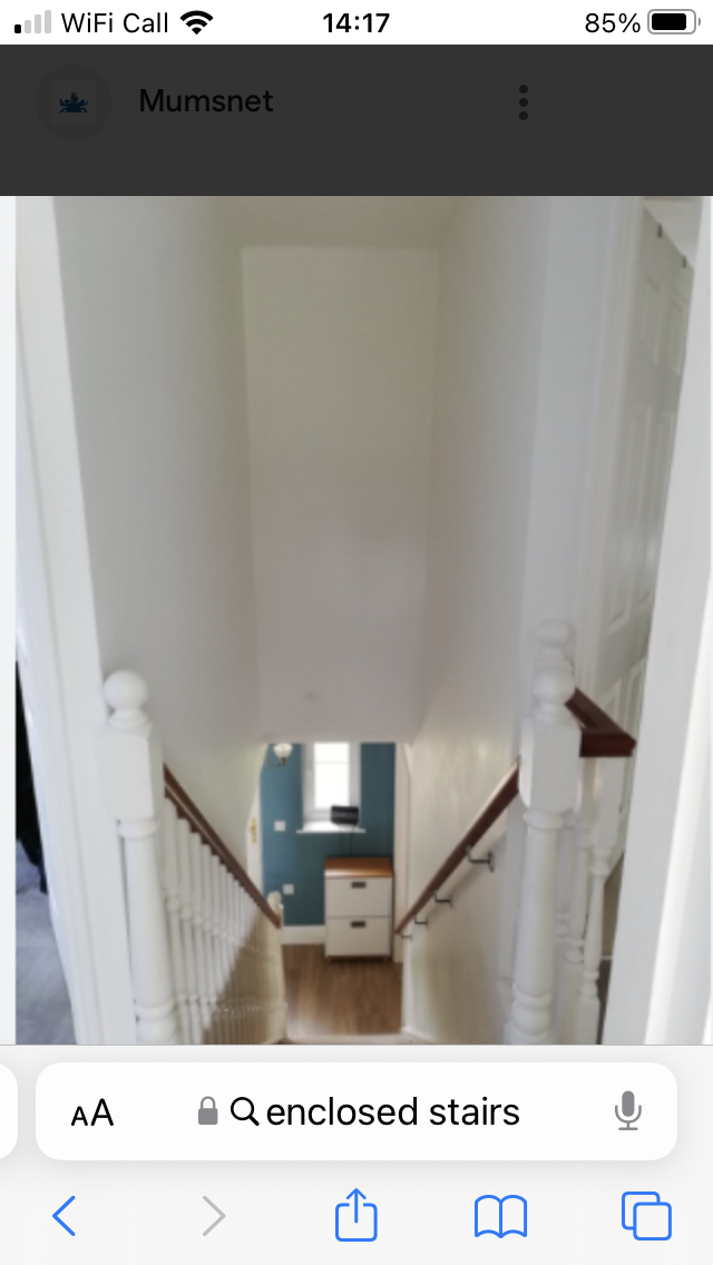

Hi we have a stair case like this however we would like to make the ceiling higher in this section so it eats into some of the loft… maybe 1 metre higher then it
Is now.
I can appreciate the joists in the loft will need this section cutting out and also aware the joists are there to stop the roof from spreading . If I was to re attach the ceiling joists higher up onto the eaves would this be a acceptable method or is there a better way? Thanks

Do you mean the flat ceiling above the picture or the bulkhead in the picture? Also ....... why?
Yes that’s the one :) we are wanting to board that section out and make a little office area however to have clear headroom for the main stairs it will have to be higher thanks Jake
