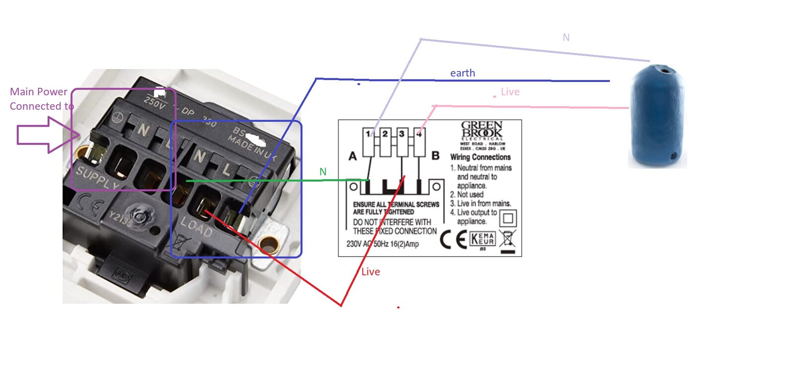

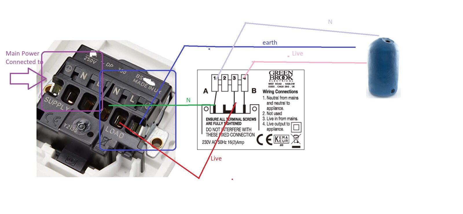

Is this diagram to connection looks good to you?

Your diagram above is correct.
If the flex cable to the immersion is long enough, then often this cable is simply used to go in and out of the new timer, with no need to disturb the DP switch..
Connecting the flex cable Earth wires together within the timer.

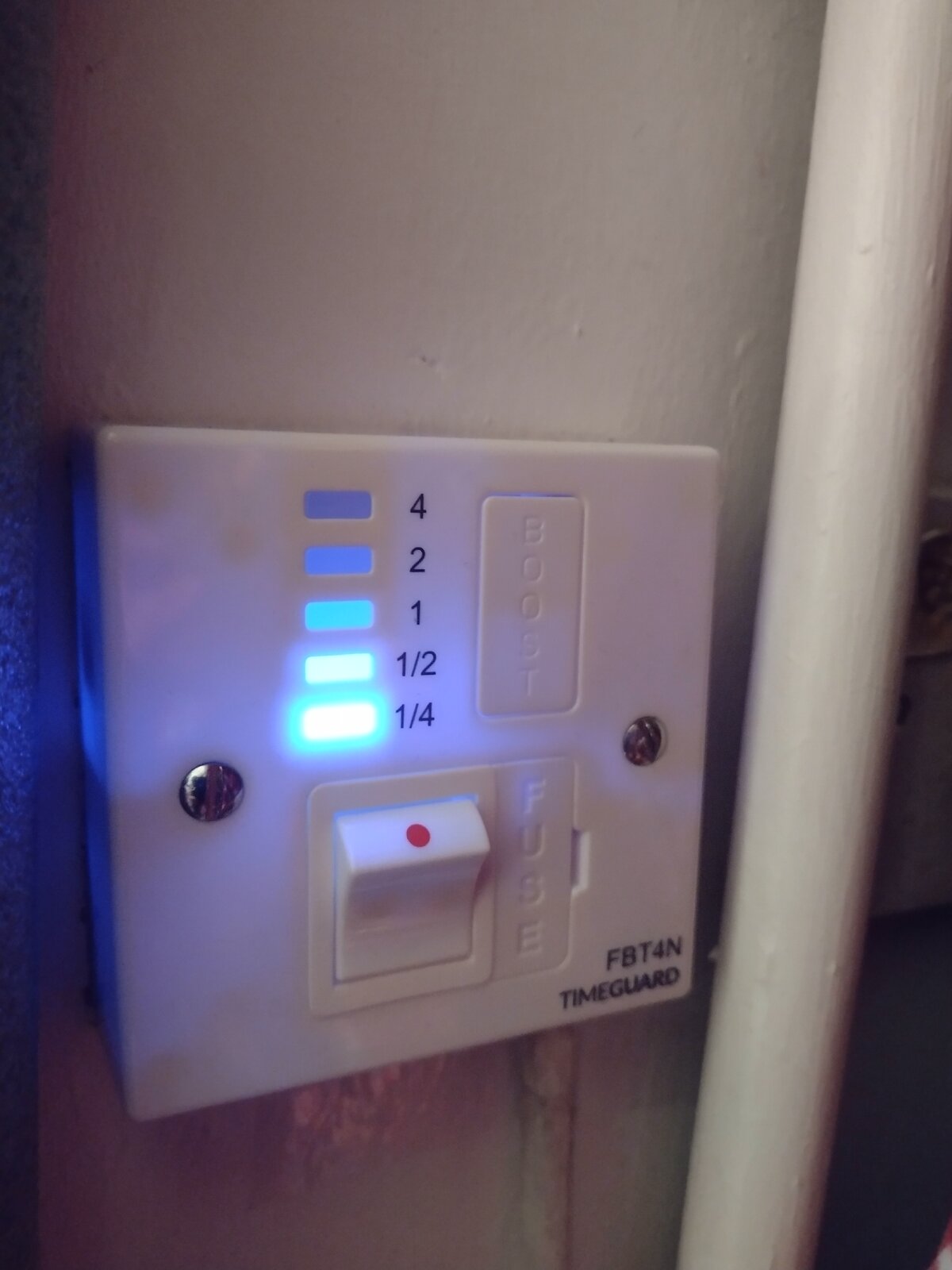

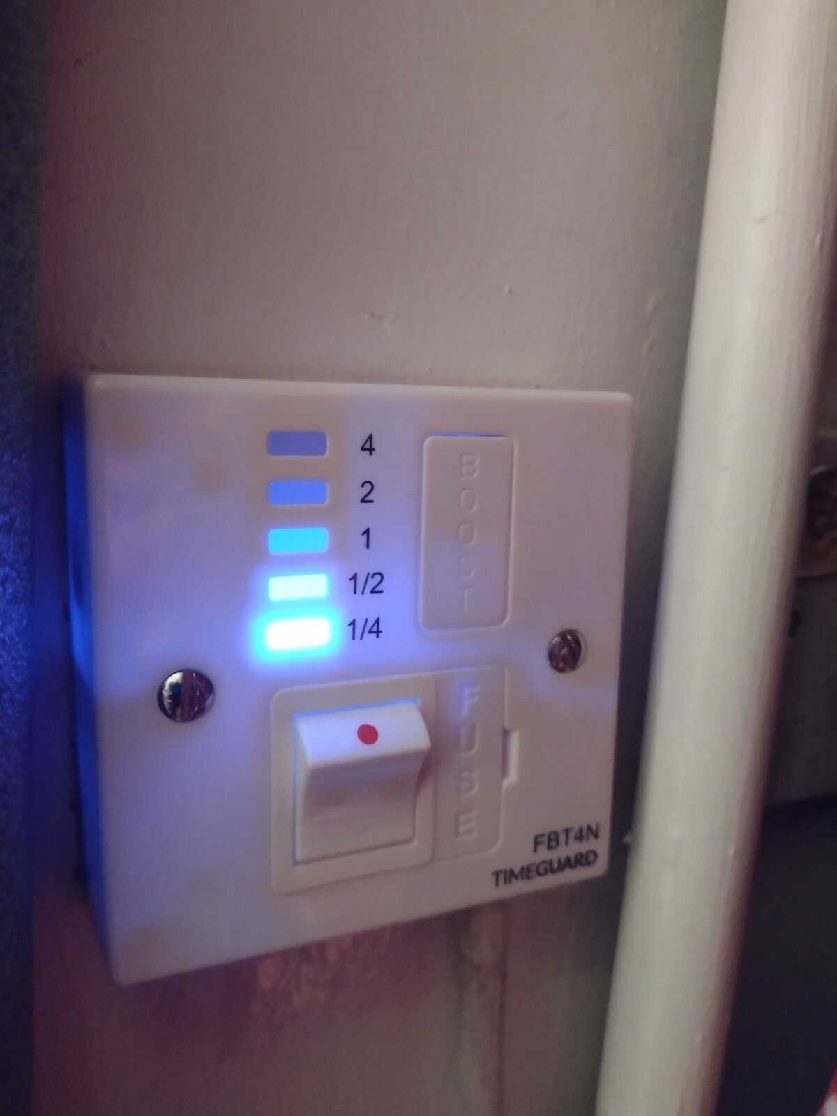

I just found another device which is TIMEGUARD FBT4N 4 Hour Electronic Boost Timer (double poles). I guess I can replace my 'MK LOGIC PLUS 20A 1-GANG DP CONTROL SWITCH WHITE WITH NEON' with it. Or fit it downstream of the DP switch.
If I just replace my 'MK LOGIC PLUS 20A 1-GANG DP CONTROL SWITCH WHITE WITH NEON' with it. Do you think it will work? So, I don't need to create another hole on my wall
Thanks everyone. I replaced 'MK LOGIC PLUS 20A 1-GANG DP CONTROL SWITCH WHITE WITH NEON' . FBT4N solve my problem :)
