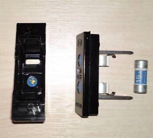

Hi,
I have a fused outlet in my garage that I want to re-use. It currently (no pun intended!) has a 30A MEM MEMERA Cartridge Fuse fitted. This to too large for my needs and I could replace it with a MEMERA 15A fuse which is closer to what I want.
However, I would like to fit a Circuit Breaker rather than a fuse (an RCD would not be suitable for the equipment to be powered).
Can anyone tell me there are "drop in" replacements for the cartridge fuse holders so I can just plug in a new, say 16A, circuit breaker ?
regards
Dave
Photos would be useful, but probably what you need is to remove the fuse carrier from the bus bar and install an MCB.
Maybe best to entrust this job to a qualified electrician if you're inexperienced with poking around inside CUs.

If it i this style you can change it easily for an MCB.
Hi,
thanks for the reply. Your picture is of a MEMERA 2000, unfortunately, mine (MEMERA only) seems to be a bit older.
I've found a photo on the net of a 15A module, but the profile is the same as mine
regards
Dave[/img]
Hi Again,
thanks a lot for the confirmation - it is pretty much what I expected, but in best "straw clutching" mode, I thought it worth a try asking just in case.
regards
Dave
