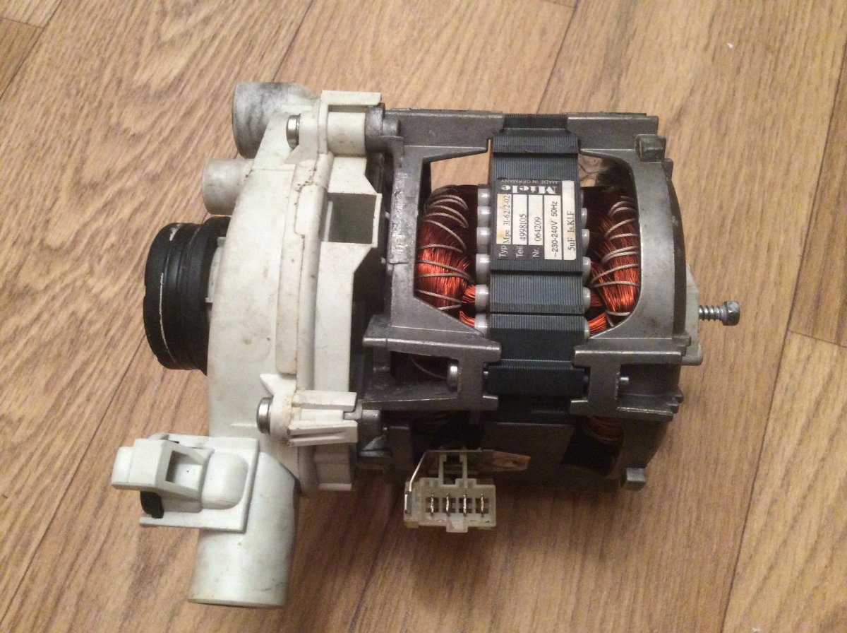

hi guys,
im trying to find the problem with my dishwasher the inlet/drain is flashing.
the drain pump works,i have also checked all pipes and filters and they are clear.
both impellers move as they should.I have taken the circulating pump out and ready to test with multimeter what reading indicate a good motor? what reading for solenoid inlet?
thanks in advance
