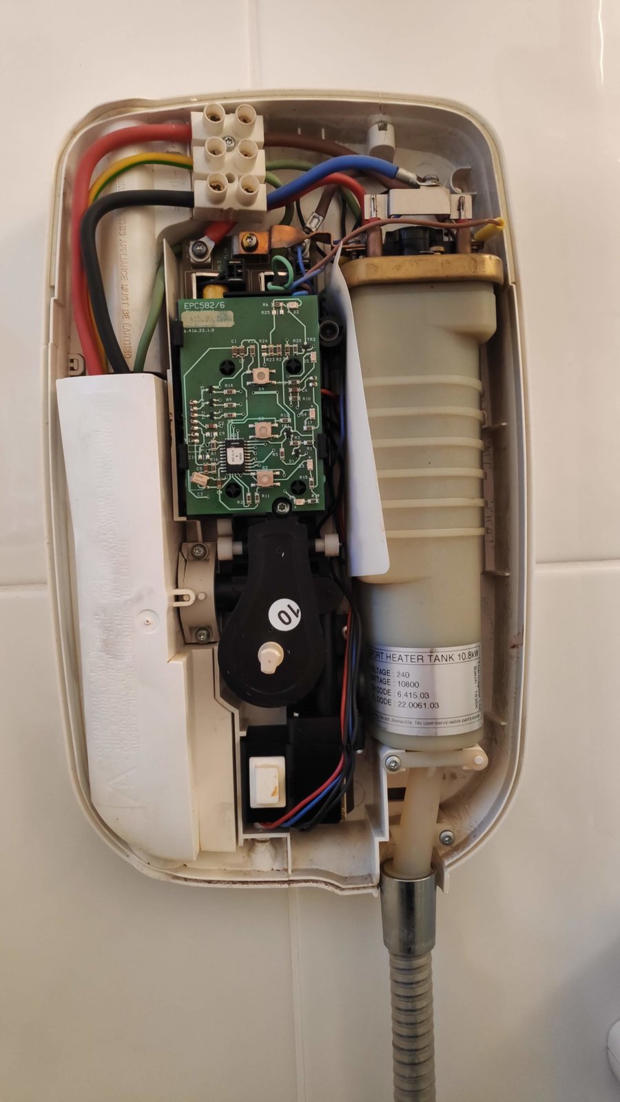

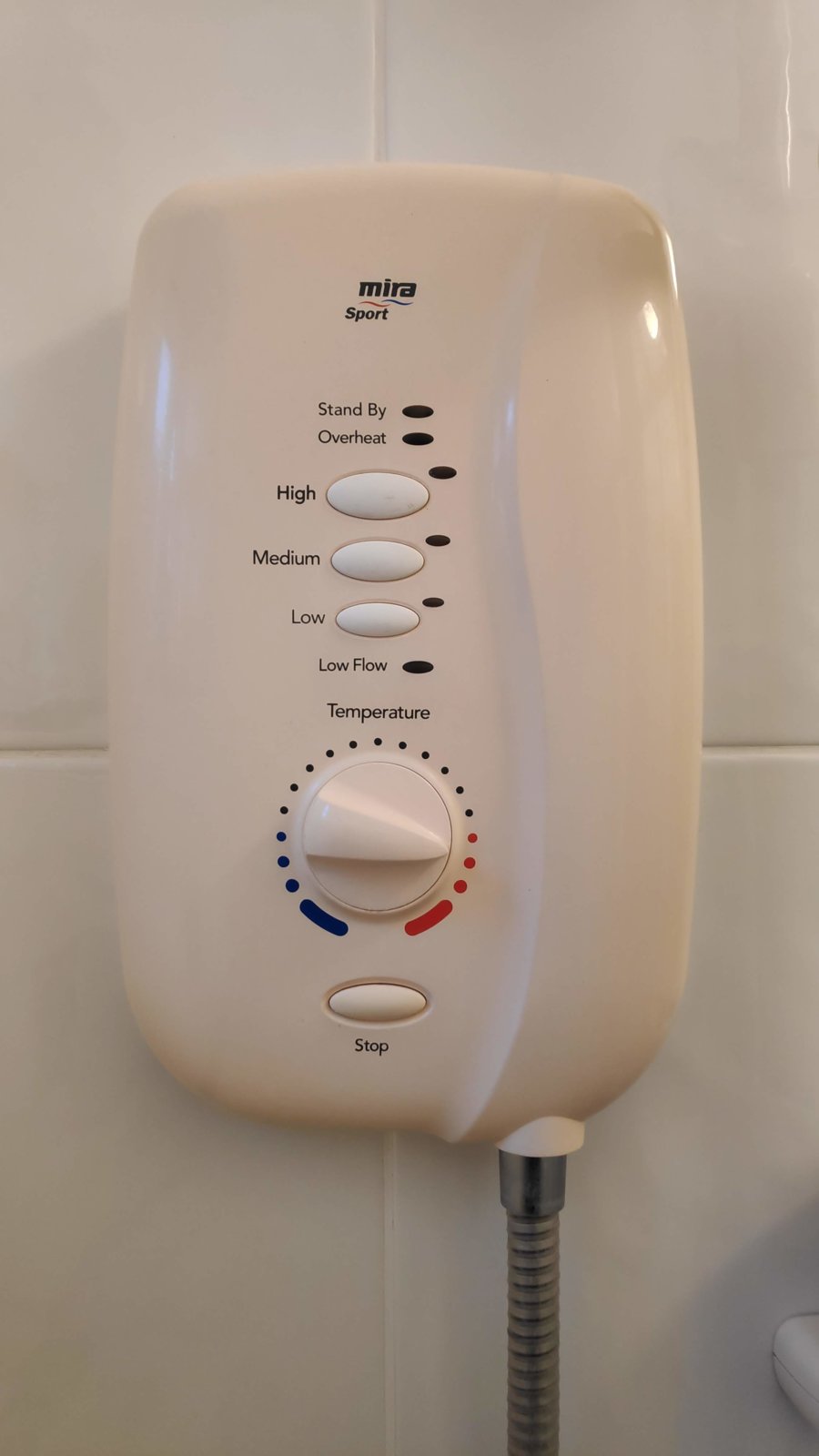

Hi all,
I have a fairly old Mira Sport 10.8kW J92C Electric Shower which seems to have stopped warming up water as normal.
The other day whilst showering, the shower circuit tripped suddenly. Found out after I flicked it back on that the shower now gives out luke warm water at the same pointer position as before and not the hot water as expected. Wondering if there are two heating elements and if one of them has broken ?
Anyone got any circuit diagrams or advice so I can attempt to buzz out the elements to confirm that's the issue - in a view to a) replacing the element......or b) just get a new complete shower unit considering this is at least 13 years old.....
Any help appreciated.
One element has failed ,probably. At 13 years old I would buy a new shower if I were you.
As said 1 elements more likely gone.
test each element with a multi meter.
