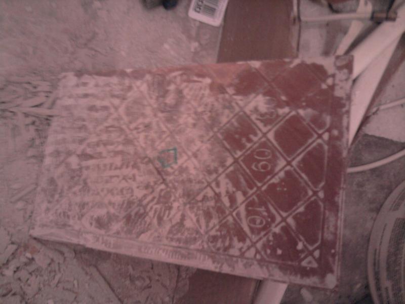

That all looks fine but I would advise you use products from the same manufacturer; as I said, B&Q stock Mapei addy but remembre to use flexible on any boarded tile base.
By boarded Tile base, do you mean for floor tiles. Or should I use flexible adhesive on Plasterboarded Walls too?
Not talking floors, that’s a whole different ball game; are you doing those as well? Plasterboard walls weather it’s a stud wall or dot & dabbed onto a slid wall, likewise any tile backer board; in fact use flexi on anything that’s not a solid wall.
No just doing the walls.

The one in your link doesn’t seem to be a specific Mapei trade adhesive which I didn’t realise before so I’m unsure. The link says it’s suitable for large format tiles, is cement based & also says flexible so I’m usure which one you were looking at in store; you still haven’t said what you’re tiling onto! Maybe it has a retarded in it to make it more DIY friendly; should be fine but I have never used it so :confused:

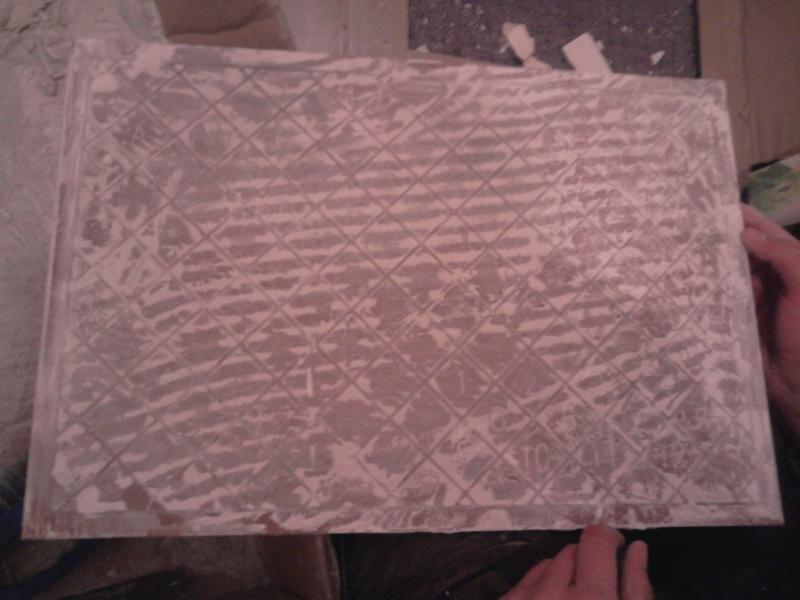

Rapidset will grab a tile & hold it there in just a few seconds so work quickly & accurately; fix tile with a slight twisting motion. The bag instructions should give you guidance to mixing ratios; tub consistence is probably a good starting point but you want it thin enough to allow easy troweling but not so thin the ridges formed by the trowel collapse into each other & run down the wall but if you mix it too thick it will be difficult to tile, it will skin quickly & tile adhesion will be poor. It’s very difficult to explain as tillers won’t generally measure anything out; we just put water in a bucket, mix in the addy & know when it’s right.

Well I am tilling of mixed surfaces. One wall is stud wall, with fresh plaster board. (Well it was before the tiling) One and half wall is dot and dab plaster board and the rest is a mix of skim and part painted areas.
Thanks, I get the consistency bit. I guess not far off from mixed cement.
