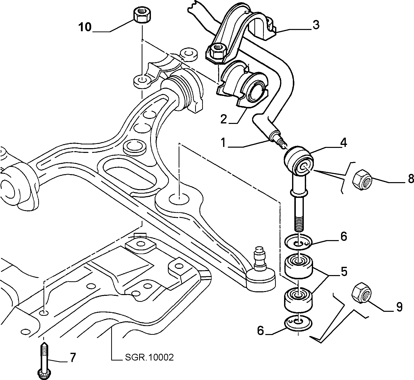

Thanks to everyone for your advice. I've had a quick look and only thing I can notice visually without a helper is that the bushes on the bottom of roll bar link where it joins to wishbone/ control are a bit perished. Items number 5 on here -

That's the anti-roll bar link. You'll get all new rubbers and washers by just buying part number 4. Unless the rubbers are totally missing, unlikely to be that though - that type of link doesn't give the knocking trouble you get with the type that has a ball joint at either end.

Doubt if that will allow wheel to rock whilst it is on the ground.
Will just give extra roll on corners (possibly) and/or knocking on bumps
When I identify the cause of the clunking, I'm also going to replace the ARB links or just the bottom bushes, at least. Just watched a YT video of someone replacing the same type of links on a Ducato. For something so simple they were a 'mare to get off. The bottom bolt and 2 bushes were no problem, but the top of the link where it is mounted on thread on end of ARB was completely seized on. No amount of big hammers could shift the link. The sleeve inside the bush must have virtually welded itself on with rust. Had to remove whole ARB in the end and cut/grind link off.
Are these types of links always that difficult? If so, I may just do the two perished individual lower bushes for now as the bush in the top seems really good. If it goes in the future, I'll bite the bullet and get the ARB out.
