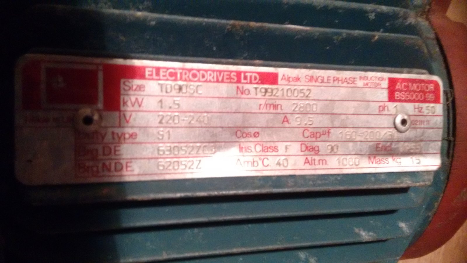

I need to know how to wire this .
It's a potential replacement candidate for a cement mixer.
I just want to see if it works before investing time and money in it.
The box has four terminals, diagonally numbered U1and U2 then 3 and four.
Also an earth post underneath.
I just want a 3core flex with 13a plug to assess it then decide further.
I can't find the OEM website for datasheet.
L&N to U1 and U2, earth to the earth post.
Motor very likely ok.

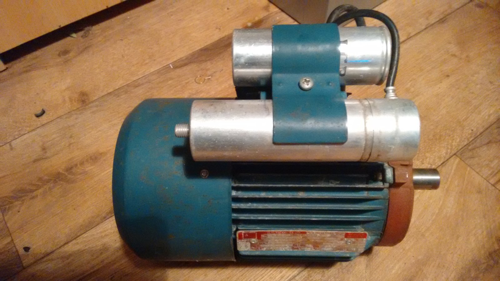

Got it wired this morning on a temporary 4m length of 1.0mm flex.
It ran for a second then tripped a 16a breaker
Fuse in the plug was intact so tried again and it runs really well,cycling the socket switch on and off with no probs
I suspect the capacitors needed energising.
Aside getting a pulley to fit and a footplate adapter made up,I just need to reverse the rotation.
So.....?
I assume this runs through a gearbox and not just a belt drive direct to the drum?
To reverse the direction you need to identify the two start winding leads and the two run winding leads.
To change the direction swap ONE set of leads over and leave the other set as they are.
E.G. Identify the start leads, (they may be marked with a cable ferrule, this will make it easier), take the one off U1 and place to U2. Take the one from U2 and place it on U1
That's all you need to do to reverse the direction.

Sorry to be thick but any clue from the picture there are ferrules marked
I'm taking one wire from each pair?
Am I making this more complicated than it is...
Thanks ,yes it goes though a 90 degree box reducing the 2800rpm down to around 40.
Sorry mate, only just seen this again.
Underneath the cappy cables you will see 4 cables with markers on them, (one of them looks like a Z2, bottom centre). Two of the motor cables look as though they are connected to the same post, bottom left.
You need to look at the two connected together and identify them. If one of them is marked as Z1 then swap it's position with that one marked Z2.
Do not change any other cables. Re-connect your cappy wires to the terminals they were on originally, (hope you marked them before removing), connect up your mains and it will now run in the opposite direction.
