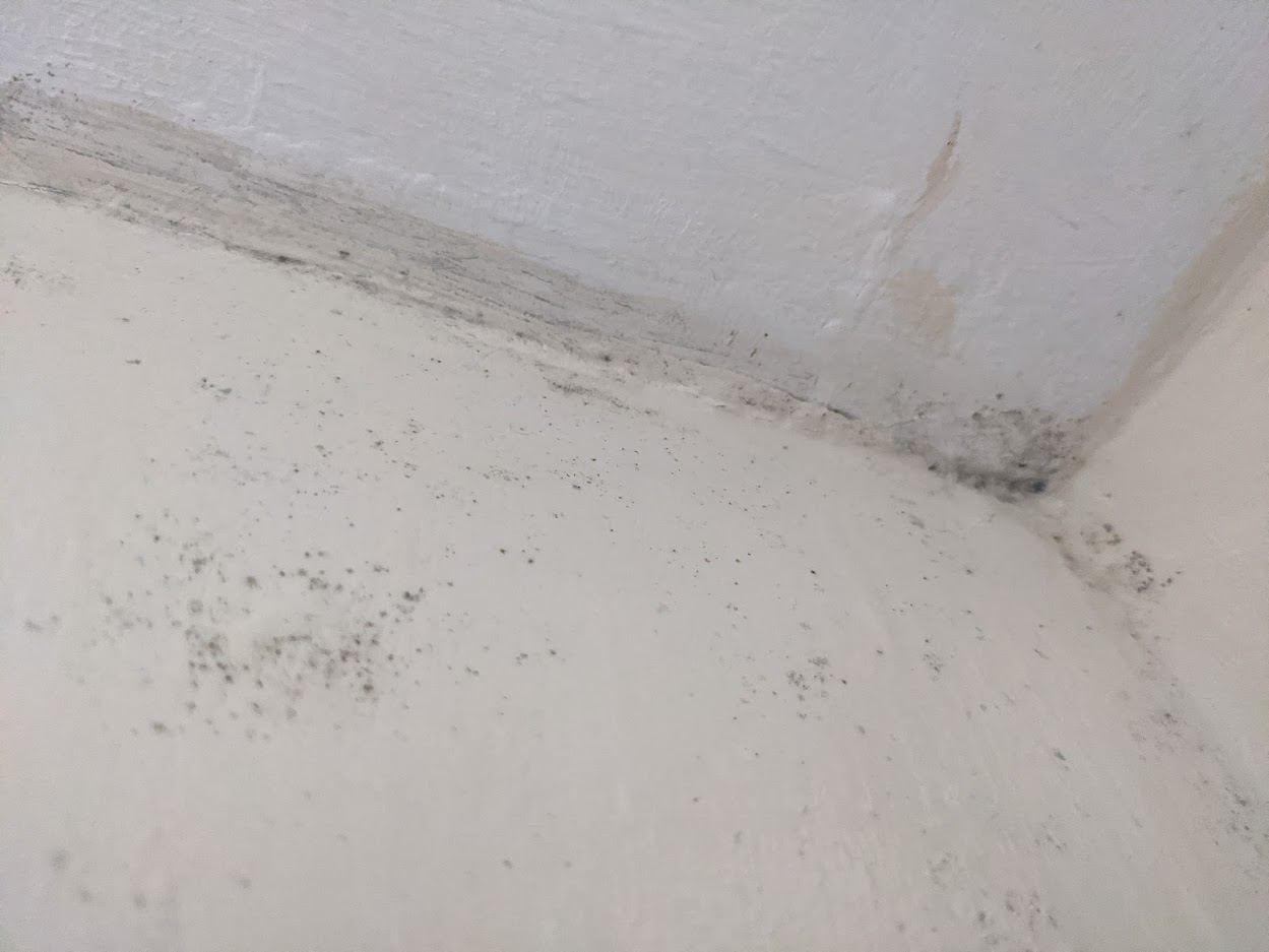

Hi there,
There is mould appearing in the corner of bedroom ceiling, hygrometer says humidity around 70% and 'wet' , the wall is external and not well insulated. (v cold)
I'm a tenant, should I try and fix myself with mould spray etc. or get landlord to look at this? I think it might cause my allergies.

As a tenant you can reduce any moisture creating activities you do and ventilate as much as you can.
What is above this area?

the roof is above, I'm on the top floor. I mean I do open the windows now and then, not sure what else can be done in bedroom.
Ventilation prevents mould, have my windows open all day unless it rains heavy, do you have fan extraction in the bathroom, must be used on every use.
is wet washing ever draped indoors?
you would do well to open the window every morning when you get up and throw back the bedcovers
and continue airing at least until you make the bed after breakfast.
If you can bear it, leave the window slightly open at night while you sleep.
And during the day if you are at home and it is not bitterly cold.
There could possibly be a cold spot forming on the ceiling. I have had a similar problem when some insulation was accidently dislodged in my loft.
Condensation occured on the cold bridge and mould formed.
The issue was resolved by resitting the insulation - making sure it ran over the top of the walls, and into the eaves, without blocking ventilation.

Probably one of the most vulnerable spots for cold bridging in any house.
If you think about it, pitched roof tile finishes, at the point where they descend towards the eaves over bedrooms etc, are only inches away from your bedroom ceiling. This also happens to be where there is least protection from the cold due to missing insulation or gaps to allow for roof vents.
I'm surprised architects, designers, Building Control don't ensure that there is more robust and more compact insulation (Celotex, Ecotherm, Kingspan etc) at this point in a building.

If it's a particularly bad cold bridge then the temperature factor for mold can be reached even when inside is 50%RH. So it's not always tenants.

The correct advice is have a combination of suitable ventilation, heating used at a constant temperature if possible (not on-off cycles), where possible iinsulate cold surfaces, and check how moisture is being produced within the home and deal with excess moisture via mechanical extraction - ie bathrooms and kitchens. Along with this, to be generally mindful as to how moisture is produced and does travel around a home to settle on the coldest surface - so either closing doors or moving air constantly helps prevent condensation and mould build up.
Whilst mould from condensation is often deemed a tenant "lifestyle" issue, there are factors that can make it a structural issue and therefore a landlord responsibility.
