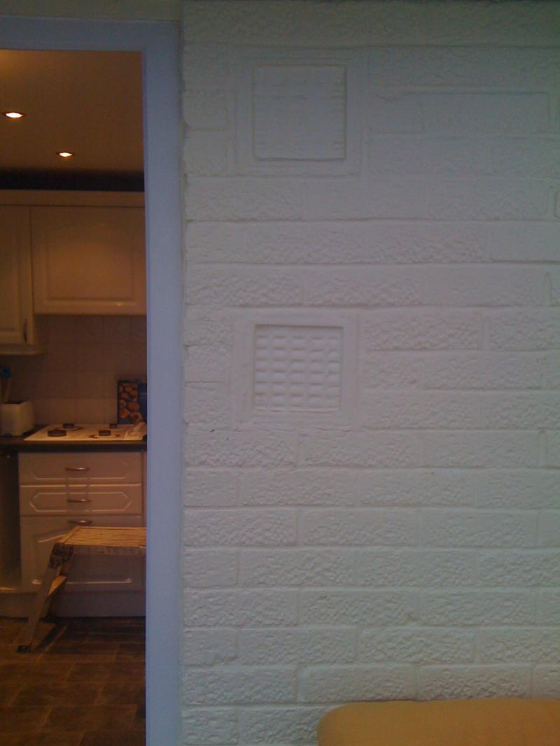

Thinking about it....attached to the kitchen is a conservatory, it which i have found two grill like bricks that have been painted over! Could this also be causing a problem?

I plan to have the conservatory wall skimmed in the new year...shall I remove the old painted air bricks and put new in? They are about head height! Could I then put vents at floor level in the new plaster board that goes up?

The air brick may have been to ventilate the kitchen, or possibly an old pantry that has been removed. If it is not for the floor, and does not go to outside air, it may no longer be useful.

The old air vent in the kitchen would have vent externally, but when the conservatory was added they had some sort of sealant put in the actually small vent holes and painted over.
