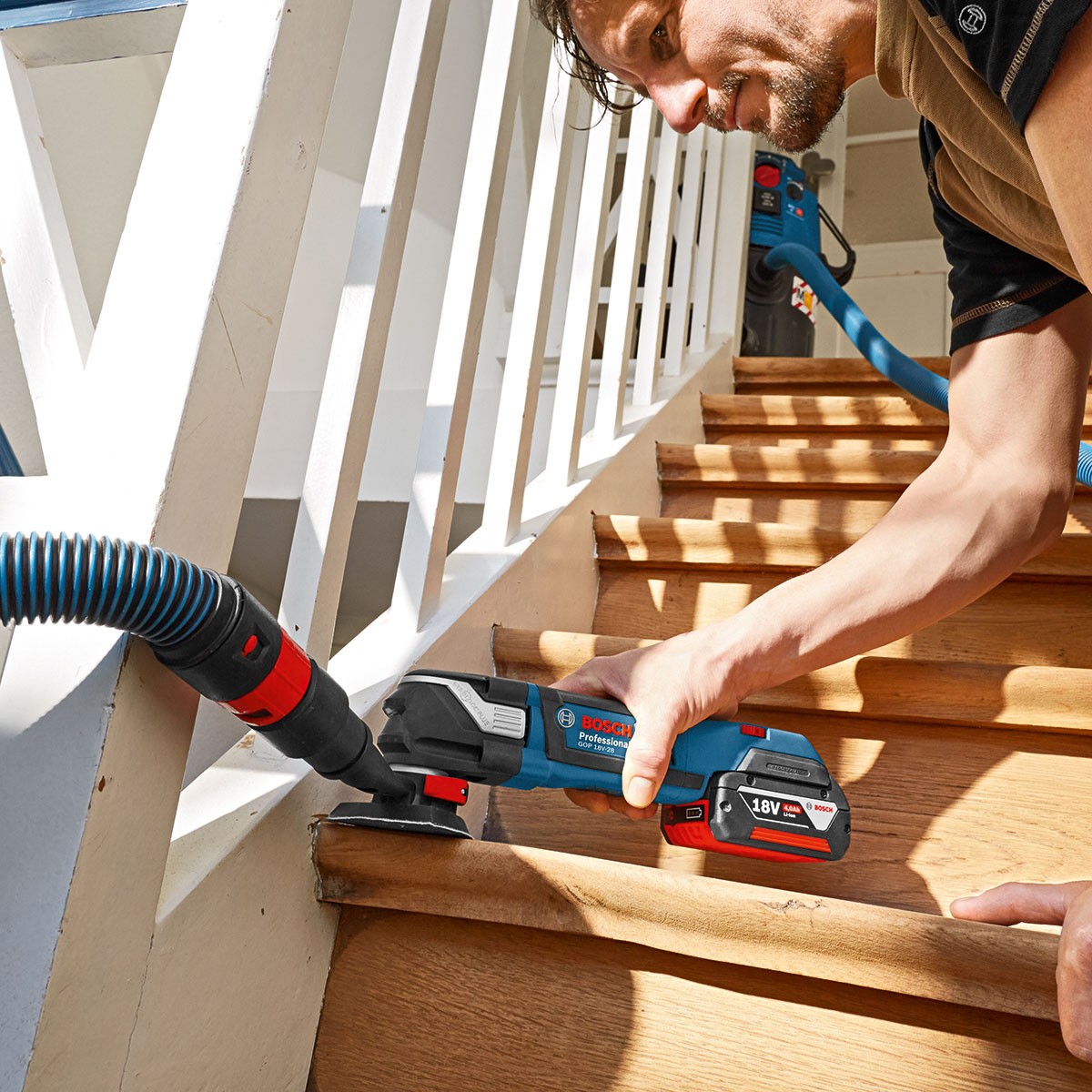

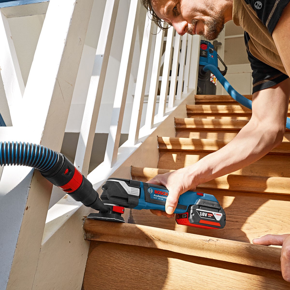

Depending on brand you can also get dust attachments for delta pads. Can be a bit awkward with the hose attached but certainly better than breathing it in.
