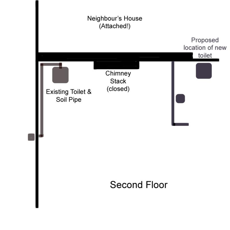

We would like to move our bathroom to this new layout
How do we move the waste around the chimney? I presume there needs to be some sort of 'drop'? As we are attched to neighbours property we cannot go out through that wall! :confused:

Can you put some dimension on there? In which direction do the floor joists run? It looks pretty torturous & you must have a fall on the drain (minimum 1:40 ideally) or it won’t work. It must also comply with several Building Regulations & is controlled building work so you should be submitting a Building Notice, having it inspected & possibly tested to get a compliance certificate which you will need to produce in the future. If your kitchen is immediately below, are there any foul drain runs in there? Is there a downstairs loo? What sort of floor is it in the kitchen below?

Many thx for the swift reply. I have attached another pic with info' for you.
BC have been advised and subsequently approved all works we intend to do btw :)
We are putting in a downstairs loo, which has an existing soil pipe. This is an option I guess but the pipe would be further away than attaching to the one which is being used at the mo' (if that makes any sense!?)

Personally I think you're asking for trouble. The pipe from the new W.C. position needs at least 4 bends to get around the chimney breast, it's going to have to be run above floor level as the joists run the wrong way, and it may prove difficult, if not impossible, to get an adequate fall on the pipe.
Pulling that lot apart to clear it when it blocks will not do your carpet/decor any favours..... :( I'd look for another route to the drain if you really must have a W.C. there.

The joists are going to make an under floor foul drain run nigh on impossible & it’ll look terrible snaking around the room & dontl forget the access points; if you plan on a shower in there, how are you going to feed that, the trap will be at or below floor level. You could run along the underside of the ceiling below & box in I suppose but you still haven’t said what the ground floor construction is or exactly where the downstairs loo is.

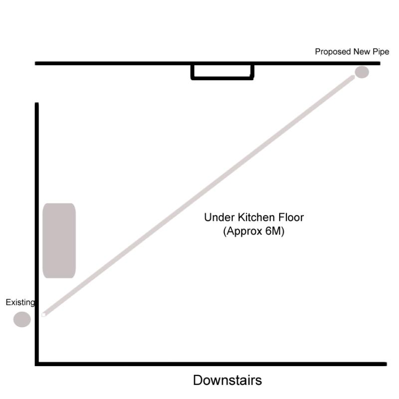

Our other option (as the house is a renovation project and not complete by a long shot!) would be to go straight through the floor down along the wall and under the kitchen floor to existing pipe. Another pic attached (please excuse my drawing!)
Looks like a pipe of approx 6m under the fllor which is suspended timber joist over what looks like 'earth' void (1930's semi detached). There is space under the floor to just about crawl around if that helps? :confused:
Based on a minimum 1:40 I guess we would need this to drop at least 150cm??

If you can get access under there it’s the obvious choice, it’s what I was thinking; job done. Maximum run for unvented 110mm soil branch is 6m so you will need to ventilate, either via an open stack through the roof or, as you appear to have at least one other open stack, an AAAV (Durgo) valve. Make sure you support the pipe run adequately & provide rodding access to satisfy BR’s. Remember, you will also need to submit a building notice, notify for inspection at required stages & possibly do a BI witnessed test but not always.
Nope. Don't make it more difficult than it has to be.
150 mm ( 15 cm)
and write out 100 times
" I must learn to tell my mm from my cm " :D
