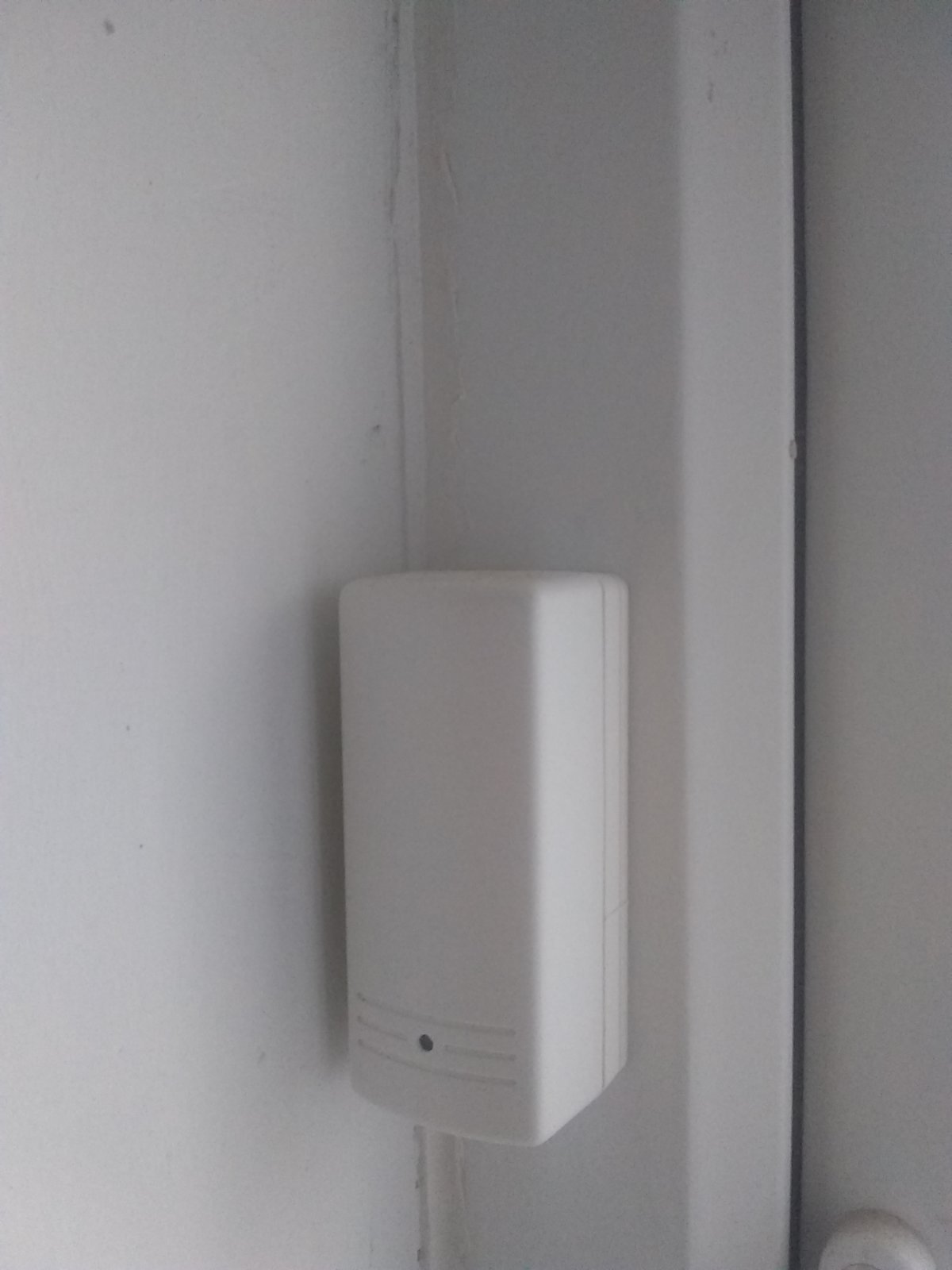

Hello i would like to brick up a small window opening.
this has a shock sensor linked to an alarm system.
could i move thus diy to another window and if so what steps should i take?
regards
Pic attached
its a wireless Risco shock.
put panel in service mode, move shock, do walk test
