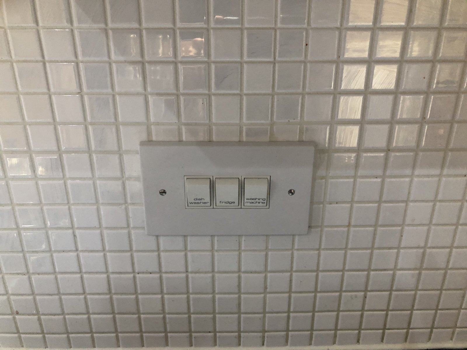

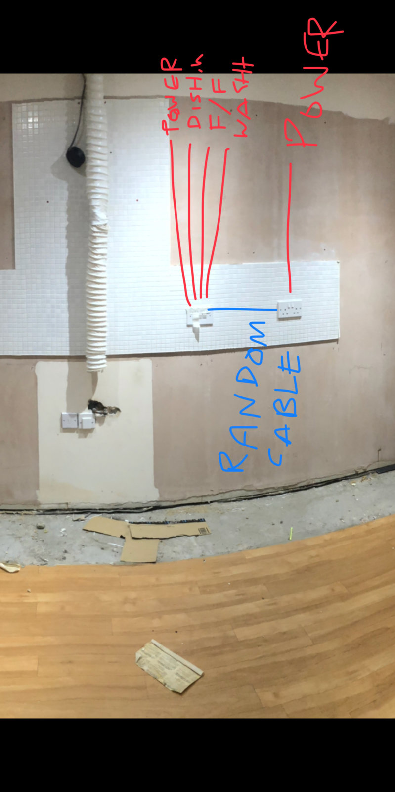

So I have a switch that isolates my dishwasher, washing machine and fridge freezer that I needed to move.
All 3 cables from the appliances run down from above as does the power input.
Also wired to the input is another cable that runs about 20 inches to a double socket off to the right. The double socket also has separate power going to it from above.
At first I thought it was a spur off but after removing the cable everything still works as it should. In addition the cable was wrapped around the mains gas pipe.
I can’t for the life of me think what this cable could possibly be. If anyone could enlighten me that would be great.
Thanks.

What kind of switch is this?
And how are the appliances connected to the cables?
You would be right to be worried about what other stupid things the previous occupant might have done.

It wasn’t occupants it was the original builders and the level of bodgery had me second guessing everything.
The switch was just a 3 gang isolation switch.
But it’s all sorted now. Thanks.

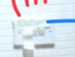

The thing that I think BAS was hinting at but for some reason didn't say explicitly is that looks like a multi-gang light-switch, probably rated at 6A or 10A and hence unsuitable for use for switching sockets on a ring.
I wasn't hinting at anything. It does indeed look like a light switch, but so does the MK K4873D2.

It isn't necessarily. You're going to have to take that switch off the wall and see if there are any make/model numbers on it, or current ratings. It might be rated for dishwashers etc, or it might not.
And what's at the other end of the switched cables? FCUs? 13A sockets?
Given that....
It’s a dedicated switch.
The other side of the cable is a switched socket.
Indeed not, but until your recent photo for all anybody knew it was a 10A light switch.
