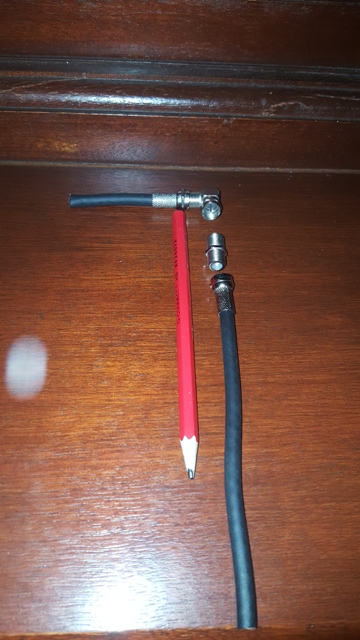

if you are able to push the cable back through the wall fit a f connector to the end then one of these then extend to wherever using f joiner and f connectors

the same sort of thing is available in traditional tv plug format but the f connectors wont slip apart

if you use the white plastic one or f connectors above you could use white heatshrink sleeving to cover the join

I did see these but was was bit worried if I cut the cable short and had one side of the connector permanently in the wall condensation may build up around the joint and cause interference, as one side of the connector would be cold being in contact with the wall and cold cable and the other side being warm on the inside, I guess I'm worrying to much though?

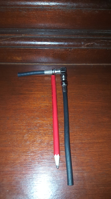

probably overthinking it. in the pic if you think of the pencil as the inside face of the wall the "in wall" connector only goes in about an inch
second pic to envisage all the bits. this is of course assuming that the cable could be pushed back through.
That's great thank you, I was completely overthinking it

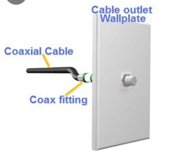

I'm liking the idea of putting a proper socket on the wall and running the extension from that, the only problem I'm having is all the sockets seem to have the cable connect from the top or bottom.
I found the Americans have some that you screw straight into the back of the socket, like the picture below
Is anyone aware of anything like this over here?
https://www.ebay.co.uk/itm/293052587885?hash=item443b4b9f6d:g:RxwAAOSwLXFc3pWF
