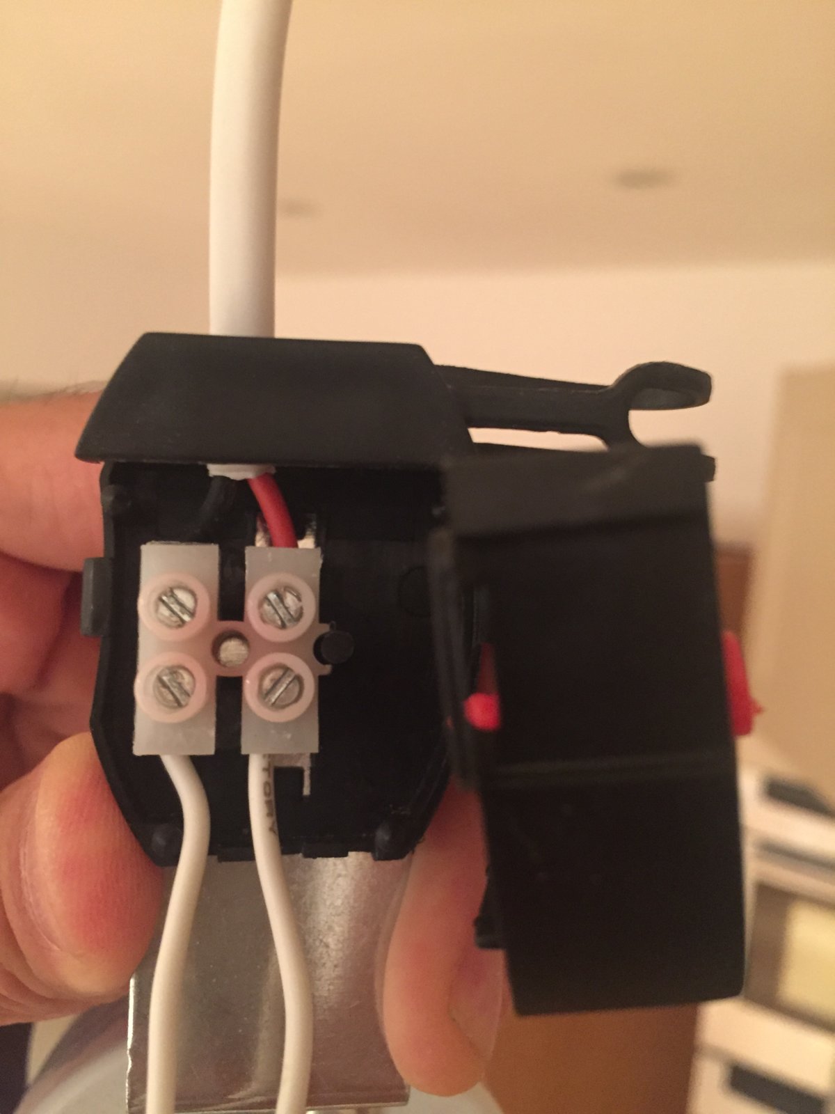

Hello
It would appear that I need to replace this part in the attached photo in my ceiling spot light. I've already replaced both the lamp and the MR16 wire between the light and this black box and it didn't help so my next step would be to attempt to replace this white connector which, judging by the picture, seems burnt if I read it correctly.
Just don't know the name of this part :)
Thank you

That terminal block looks fine. It's more likely a faulty transformer.
Thanks.
I did have a transformer problem with another light, I replaced it with this one and it solved the problem
60va Electronic Low Voltage Lighting Transformer https://www.amazon.co.uk/dp/B0018RPT5A/ref=cm_sw_r_cp_api_gMEMzbAVGJYX7
I just noticed a bit of burn marks on the terminal block (now I know it's name) so assumed in needs replacement.
I can order a replacement transformer but how can you tell the terminal block is definitely fine?
In my experience there looks nothing wrong with that terminal block.
Terminal blocks do sometimes burn up but as Lectrician says yours looks not to bad.
As a guide if the screws still move and you can still remove the wires and when removed the wire ends look ok and not melted or discoloured, then the fault is likely elsewhere.
There will only be a Transformer if the lamp is 12 volt, so be carefull sometimes inside that black box the connectons are mains voltage 240 volt

What on earth do you mean by MR16 wire? MR16 refers to the type of lamp, multifaceted reflector 16/8th of an inch in diameter. MR 16 lamps can have various bases such as GU10, GU5.3, E14 etc.

For much better reliability replace it with a proper transformer not another switch mode power supply.

GU5.3 Base
@royc75 before you go buying anything. First of all, unscrew the wires from the terminal block and have a look at the ends. Sometimes a numpty installer has screwed down onto the insulation. it makes conatct for a while and then fails.
Worth a look.
If you have a test meter, you can just check that there is voltage at the terminal block and at the input to the transformer.

Thank you I have already ordered the transformer but will check voltage on the terminal block as well as suggested :)
