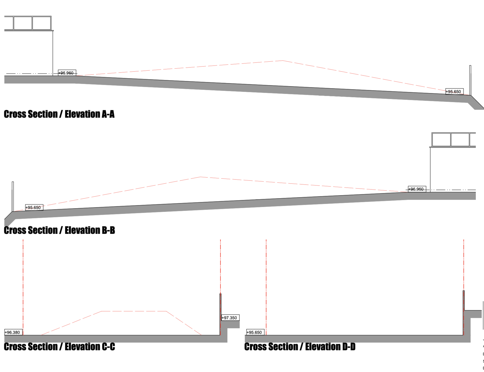

Her neighbour has been building an extension which required a lot of excavation of soil for a new basement room.

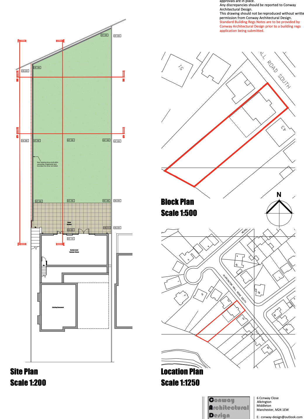

Rather than having the soil removed, this neighbour wants to raise the level of their rear garden which naturally slopes away to a nature reserve at the end of the properties. They've put in the following planning application:
http://documents.rochdale.gov.uk/pav/planapp.aspx?MyQueryID=108&OBKey__705_1=21/00670/HOUS
This is separate to the extension build which has already been approved and work is underway with soil already been dumped on the garden.

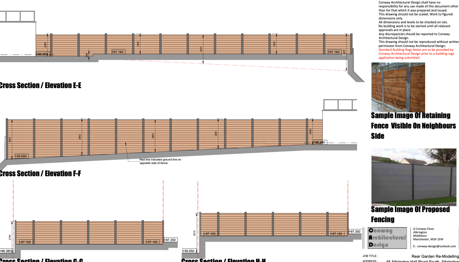

The upshot is my friend is going to end up with a huge fence that is up to 3.5m high in their garden, because the neighbour still wants a 1.8m fence on top of their new ground level. Proposed elevation F-F below is from her garden.
Obviously my friend isn't very happy. Not only will this create a massive ugly wall, currently the boundary is planted with various hedges/bushes which straddle the boundary, so she's going to lose a lot of greenery from her garden too.
I am conscious that you must object on the planning policies of the council, but what are the key things she could object to here?

- Structural integrity - there is no details of foundations, and a retaining wall made of wood holding back up to 1.7m of soil wouldn't last long. Not sure if this would be BC not planning, but sure the plans must have adequate detail to assess the overall nature of the PP?
- Danger of collapse at the end of the garden - elevation E-E seems to indicate a sheer cliff of soil at the end of the neighbour's garden, with nothing to retain the additional soil, just a fence on top.
The PP form is wrong because the work has started, trees/bushes are in the place and a couple of other things.

Visual impact certainly, its a depressing industrial-looking fence even at 1.8 m, let alone nearly 100% higher than any normal garden fence, and belongs around a prison not a family garden. Then you have all the shading, shadows, lack of use of the part of the garden that "the family love using for family time in summertime".
Mention how anxious this will make the family feel, and other feelings that it will create - which is important to get across. The constant worry of it blowing down in the ferocious gales that frequently occur.
The materials, it looks plastic, even so it will create sound echos and reverberations, amplifying wind and other noise to sound like thunder. "How can a family, elderly grandparents wanting a peaceful afternoon relaxing bear such such unbearable noise?" (Even if there are no grandparents)
Drainage may be a planning concern. Where will all that water running down the fence go to? Where will the higher land drain to, and how?
Why can't the fence be stepped down like any other family garden? (A rhetorical question, you know why)

It does appear that the drawings are intentionally designed to mislead, in the way they have drawn the proposed ground levels in the red line section - which is totally impractical. Perhaps drawn like that for the approval but then the ground will be levelled across?
