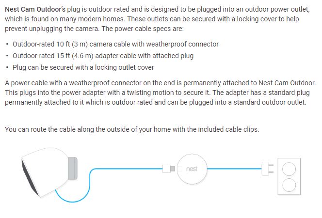

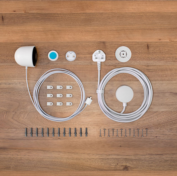

Thanks for the reply. Pretty sure both rings are already RCD protected at the Consumer Unit. It was just a precaution as the difference in price is negligible.
The camera cable has a three pin plug.
I just wanted to make sure there are no issues placing a socket 3 metres up an outside wall.
Cheers.
Yes but is it an ordinary plug or a wall-wart with power supply?
If it is an ordinary plug then cutting off the plug and just fitting a connector would be better.
There are no issues with a socket but an RCD out of reach would be, as I said, silly - an unnecessary one sillier.
The cable....
I don't think there is anything to stop me cutting off the plug and re-terminating a permanent connection.
