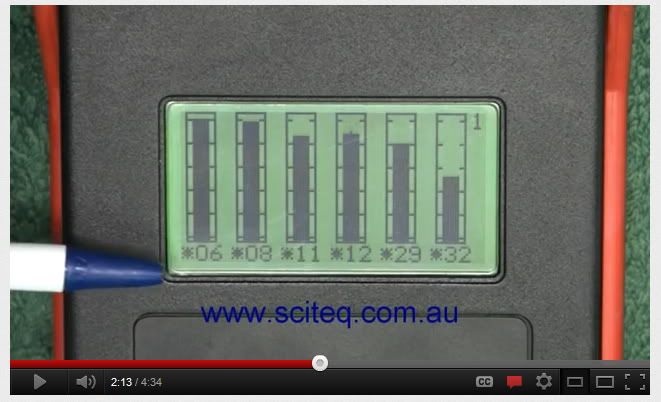

Well surely if he's a pro installer he willl have a decent meter? My Horizon meter shows the strength of each Mux in an easy-to-read bar graph for showing to customers. . It is the simple to go straight to the weaker channels and check quality as well as checking the strongest for overmodulation.

When the install is underway the installer will know which is the weakest channel group. This images shows a bar graph with relative signal levels for the MUXes. In this example the stations on the channel 32 MUX are the weakest. If there's enough signal for a successful channel lock then these stations would be the first to break up if the signal is a bit marginal.
