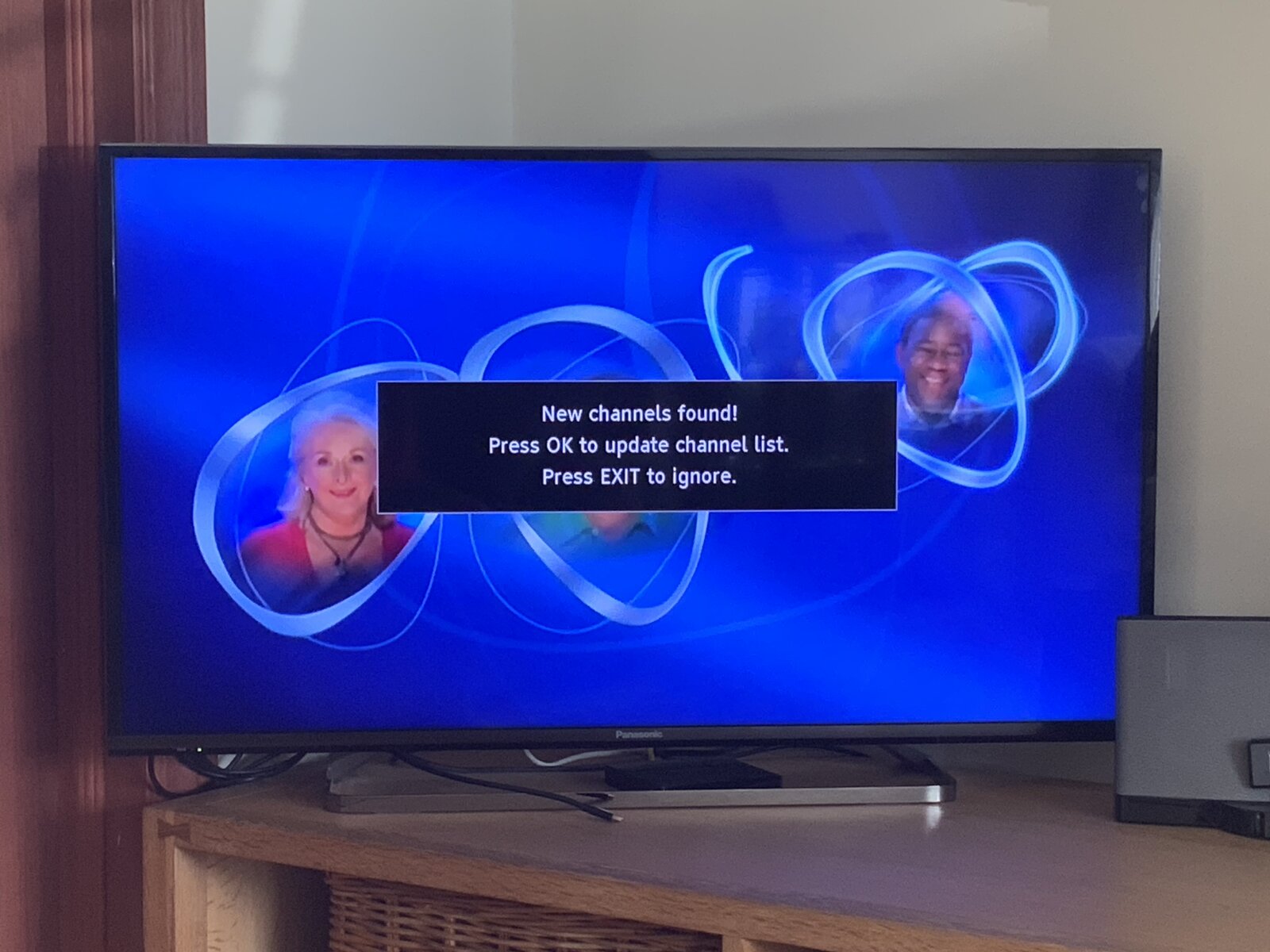

Sometimes twice a day. Is it just me - I’ve been getting these messages on my Panasonic TV for the last week. If I press okay, I have to wait a few minutes while it retunes unless I override it. The Panasonic upstairs doesn’t do that - is just says 'new channels found and added'. What’s happening?
Sounds like the TV is getting a marginal signal which means it comes and goes. When they go, the TV updates it's channel list accordingly. The next time that the signal is strong enough the the message reappears.

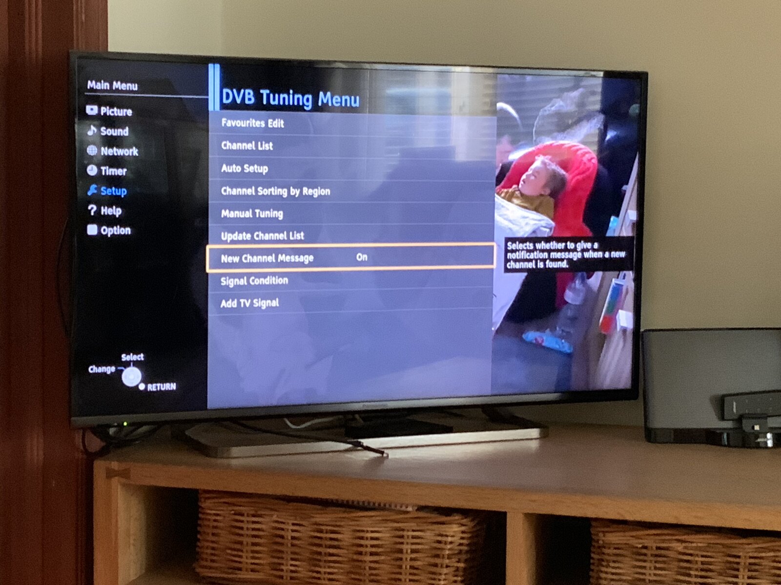

The solution is to switch off the 'Auto Update Channel List' feature.
On my Panasonic it's Menu > Setup > Freeview Tuning Menu > Auto Update Channel List > On/Off
Make sure the TV is switched to Freeview before starting otherwise the menu structure won't show the Freeview Tuning Menu.
Hit me up with a Thanks if this fixes your issue.
Not the same menu as yours but I did find this which I have now set to off. Hopefully that will cure it. (y)

normal, on my older Panasonic TV, doesn't automatically update, i have to click ok and then it takes 3mins to do the update
I get it all the time, in various different transmitter locations over the past 10years , Chelmsford, Surrey - crystal Palace & Chichester area's
Sometimes it's simply a slight change to the name of a channel.
