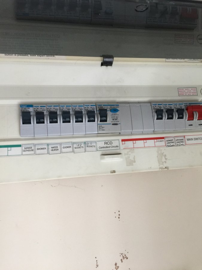

image.jpg Just checked. They are all blue. Is that a problem ?
No.
Nor is it in the slightest bit relevant.
The "problem" is that when you said it was blue I thought it was relevant, i.e. that it was a breaker in a range where the ratings are colour coded. I only know of a few makers who do, or did, that, and they don't use blue for 32A.

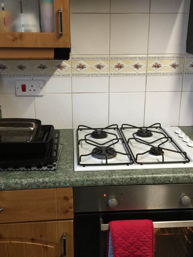

It's a 60cm wide single oven.
I really don't think we need to wonder if the oven + hob might total over 15kW.
I know its unlikely to be that powerful ban, but as it hasn't got a plug already on it then the rating could be anything (within reason). While I don't know the ins and outs of all induction hobs I have seen 7.2kw ones which the op could have but we don't know. They mentioned a standard socket behind the oven, I don't know if that's a cooker point or a standard 3 pin socket so they might of been toying with putting a 13amp plug on it?
My main point was to get the information of his hob so we can help him identify the wires and offer some confident and safe advice.
OK - so, 7.2kW hob and a 3kW oven?
Or a 3.6kW oven, assuming a mainland-Europe model?
10.2kW or 10.9kW total?
So well within the capacity of the circuit that I simply don't see how it could ever be so much more than assumptions like that that it would be too much.
Ok maybe my comment about the circuit wasn't specific enough to what I was thinking / concerned with. We still need the hob info in order to help the OP
Well, I guess i's should be crossed and t's dotted, but given the size of the one he is replacing I can't imagine the new one being 12kW or more.
Sorry for the delayed response. The new hob is 7kw. Not sure on the oven wattage but that is fitted as standard with a normal household 3 pin plug. The circuit is only used for the cooker and eventually the cooker and hob combined.
So the two add up to 10kW at most. If you keep a switch which also has a socket then you need the circuit to be rated at no less than 25A.
