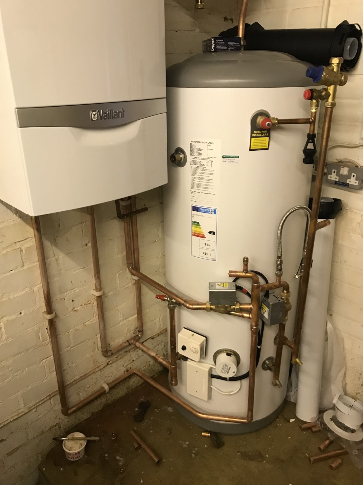

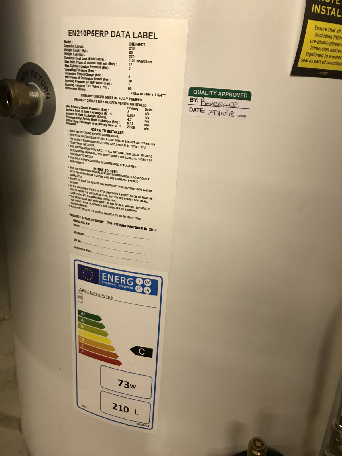

A few pics
you already have an unvented cylinder installed so why are you asking these questions
