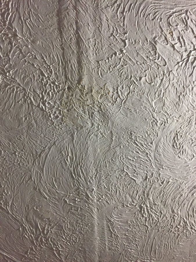

That night, I noticed that water was coming out from my light fitting downstairs in the dining room (this room is slightly below the radiator upstairs and boiler upstairs) and dripping onto the floor. I immediately turned off the light section from the fuse box and took down the light fitting. I called the plumber and he explained that it was probably water coming through from the leak earlier.
He came out the following morning, drilled holes in the ceiling and collected the load of water with about 4 buckets. He then filled in the holes, left and explained that it will all be fine.

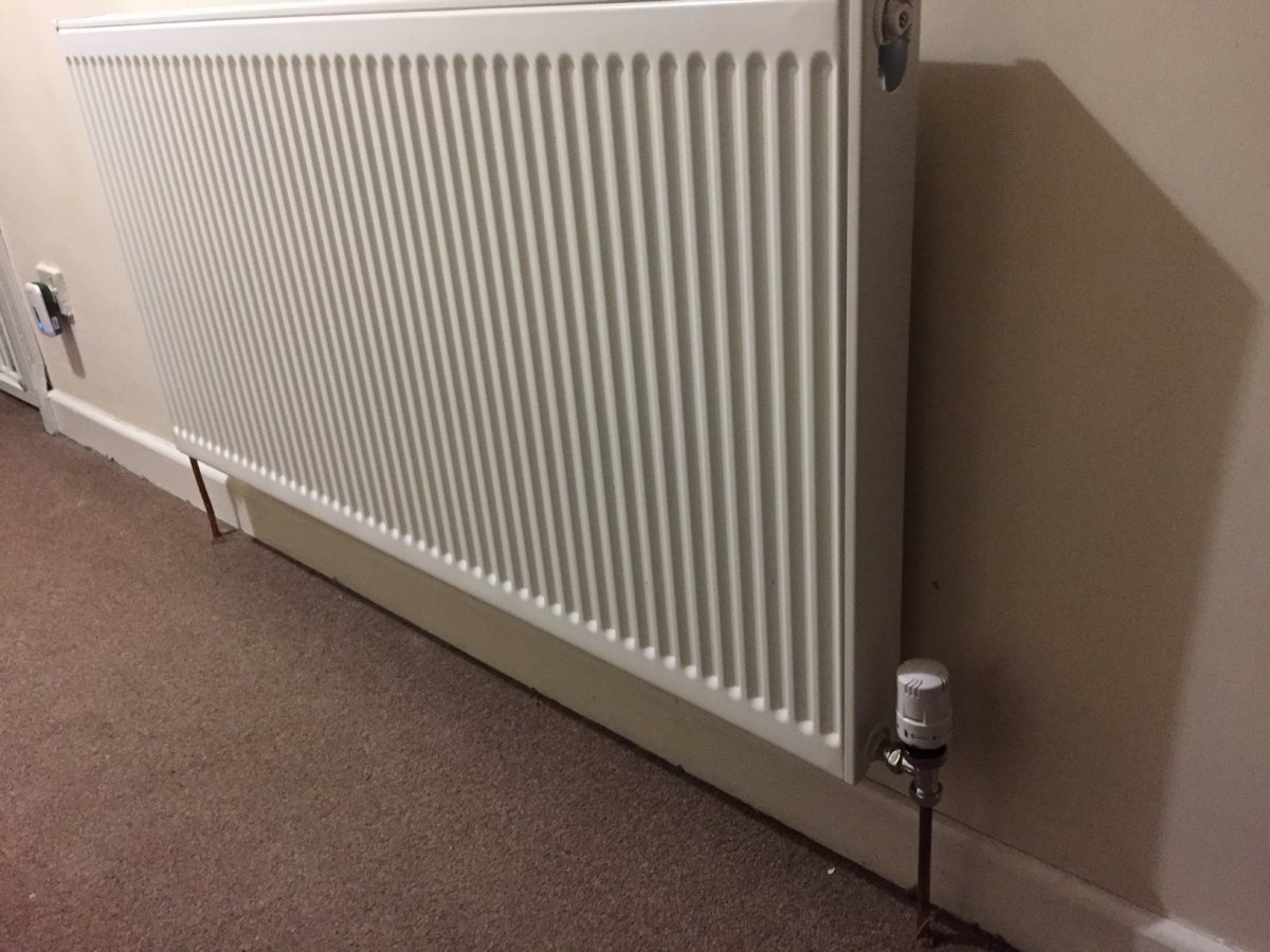

I'm not sure if these pictures would make a difference as it's all of the surface.
Landing - I ripped up the carpet and floorboards on the landing and couldn't see anything. The leak before was under one of the floorboards which I couldn't dig up, it seems like it is stuck down solid.

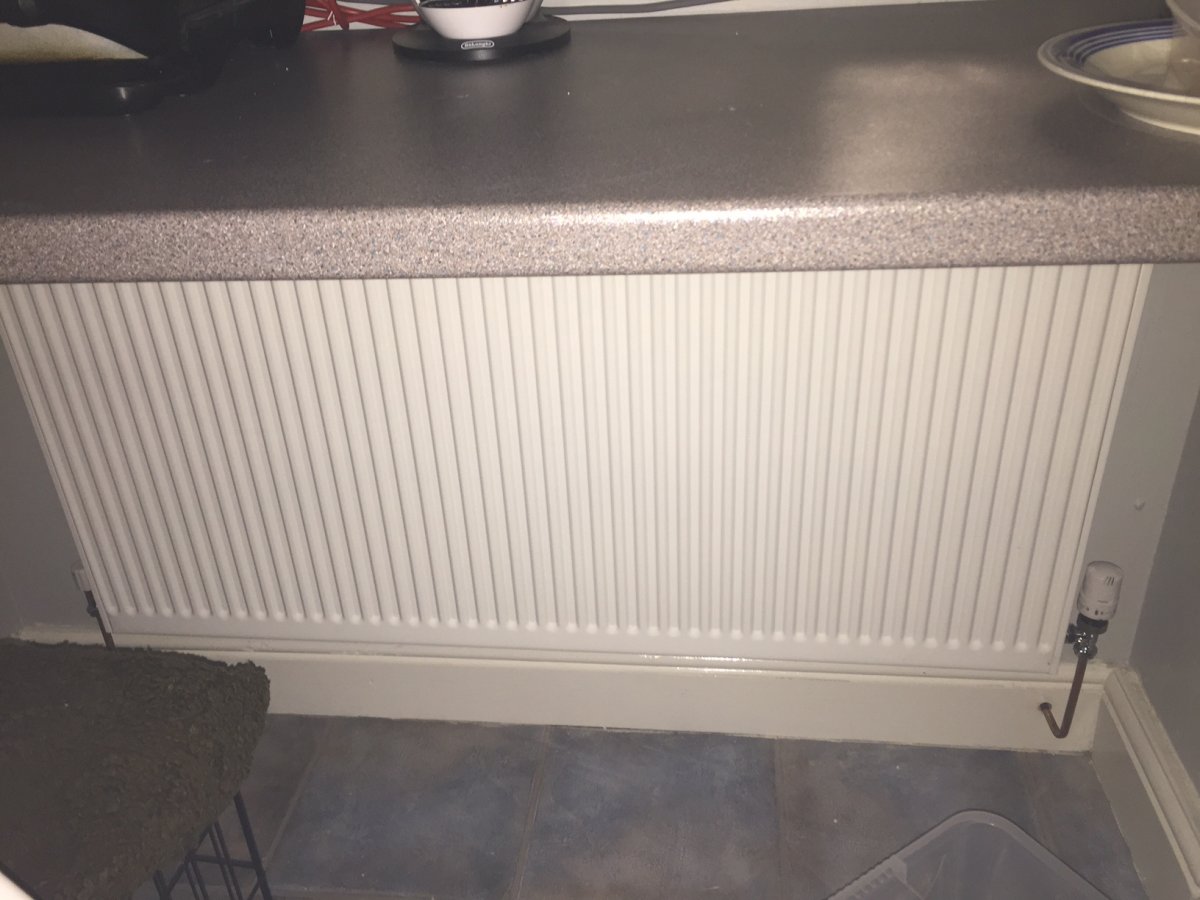

Kitchen - I'm lost about the radiator being cold at the bottom though. There is a radiator directly behind the one in the kitchen so it is connected to them pipes I imagine, but the radiator in the other room is working fine.

Ceiling

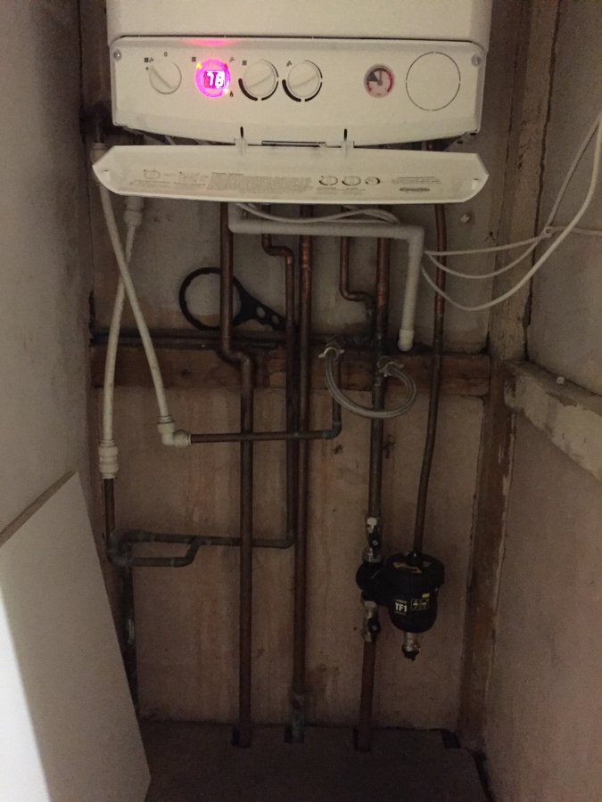

Boiler

Life lesson - pay peanuts, get monkeys. A decent installer would never leave a new installation without testing his work and, in the case of installing new radiators, re-balancing the system to ensure everything heats up at the same rate. Looks like your boiler has been slung in by someone doing it for a, ahem, "fair price" as well :-/
Your pics don't reveal anything really - need to see the new pipework under the floors where it connects to the existing system to have any idea of where they've gone wrong.
The actual boiler install has been done by a lazy feker dangling cables and plastic used and left hanging get it done in copper.
Is kitchen rad teed into same size pipe (microbore) if so thats wrong and it wont work it needs running back to or before manifold . 4 buckets full that is not a simple weep that pishing out .No rads do not fill up with air even over years let alone weeks unless there is a leak .

Did your boiler installer powerflush the system? If not how did he ascertain that the system was otherwise clean and free of sludge? There's a lot of poor work in the pipework around the boiler.
It's possible that some sludge has settled in the bottom of your new kitchen radiator, which is why the top is getting warm first.

As has been mentioned, I see minibore from your images and this needs to be T'd off a manifold or from the 15mm circuit, not from other minibore pipework that supplies an adjacent rad.
You will need to have the floors up where they have been and altered pipework and to examine every new joint for leaks! Cheaper in the long run for you to investigate this at your own pace than to pay for someone to come in and do it! If you can find the leak, we can help advise you on repairing it!
See if you can get the 'cold at bottom' rad working by shutting down all other rads, to push flow through it then, once you've got it circulating again and any sludge is in suspension, drain system down and repeat. Then you should dose with cleaner for a few days then inhibitor when leak is fixed and water is again circulating!

AND what about teeing that rad into existing same size pipework or is it bigger ?
