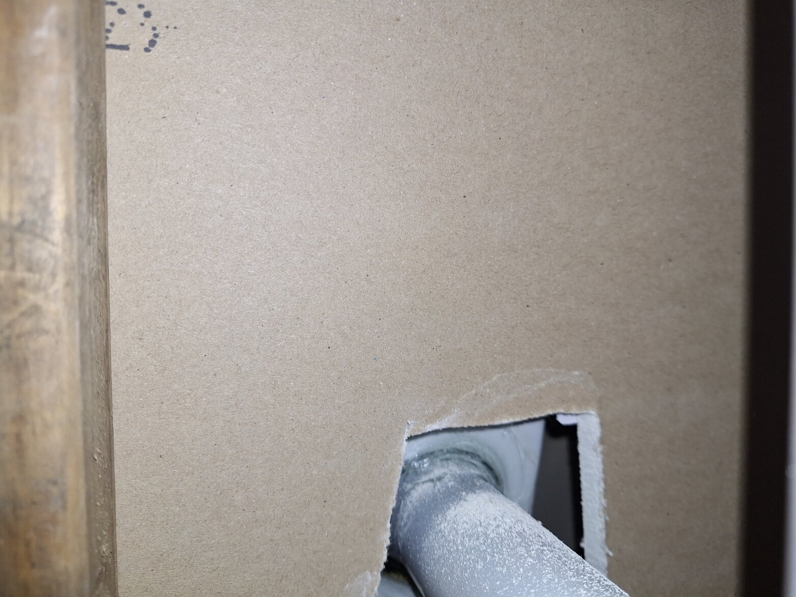

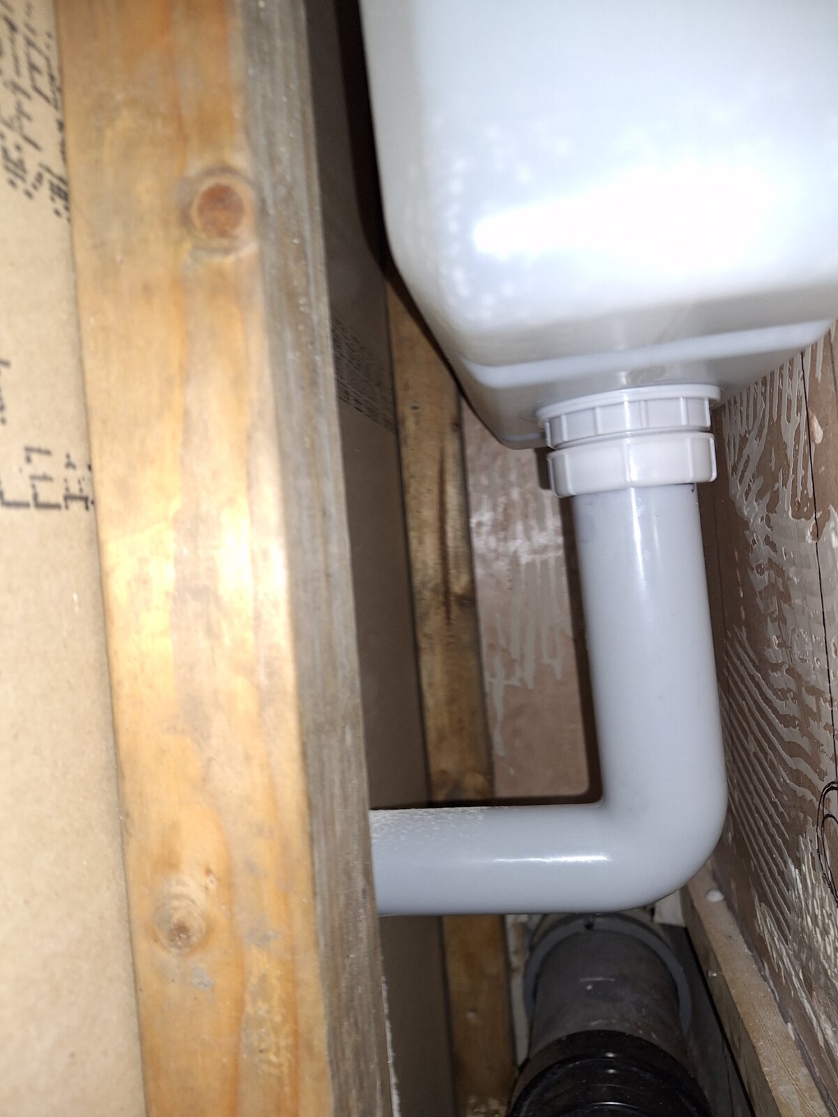

Ok, I've cut out the shelf to access the concealed cistern and had a look:
1. The cistern is filling completely - so a low water level is dismissed.
2. The cistern is installed 6-8" above the pan - so I guess there is enough height - so that can be dismissed.
I have filmed the flush operating and there seems to be a lot of gurgling and bubbles going on - not sure what that means. Could someone in the know confirm if the bubbling and water coming back up the overflow pipe is a sign that something is not right with the flush? See link:
Cistern Flush Video

OK - looking at that the cistern it has been raised as high as any would normally go, flush pipes don't really come longer than that one and cisterns wouldn't be any higher, that and it's the larger 2" > 1.5" europipe, so the drop and flow is maximised. If the cistern is full and it empties as fast as possible then the drop valve is also working properly. Don't have access via the link.
All that's left is the actual pan design, as suggested I have had mixed results with rimless as they are quite new, as far as domestic pans are concerned.
Some of his statements are just plain wrong and him swerving the issue but, and it is a big but, he has installed what he was supplied with, correctly by the looks of it and there's not a lot that he can do about bad pan design. Instructions wouldn't help here, there is nothing that the MI would tell you that would help with the actual flush and flow of the water, cistern heights, sizes of flush valves etc, the manufacturers just don't supply that type of info in toilet pan MI's that I've ever seen, very little is included in the docs for pans.
