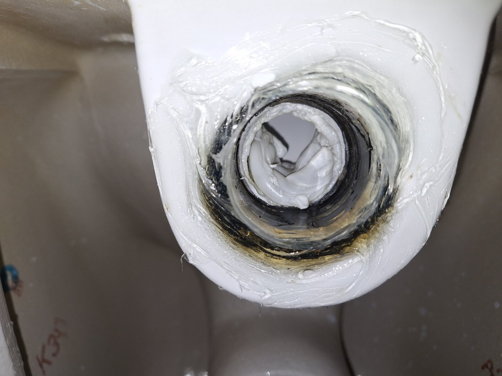

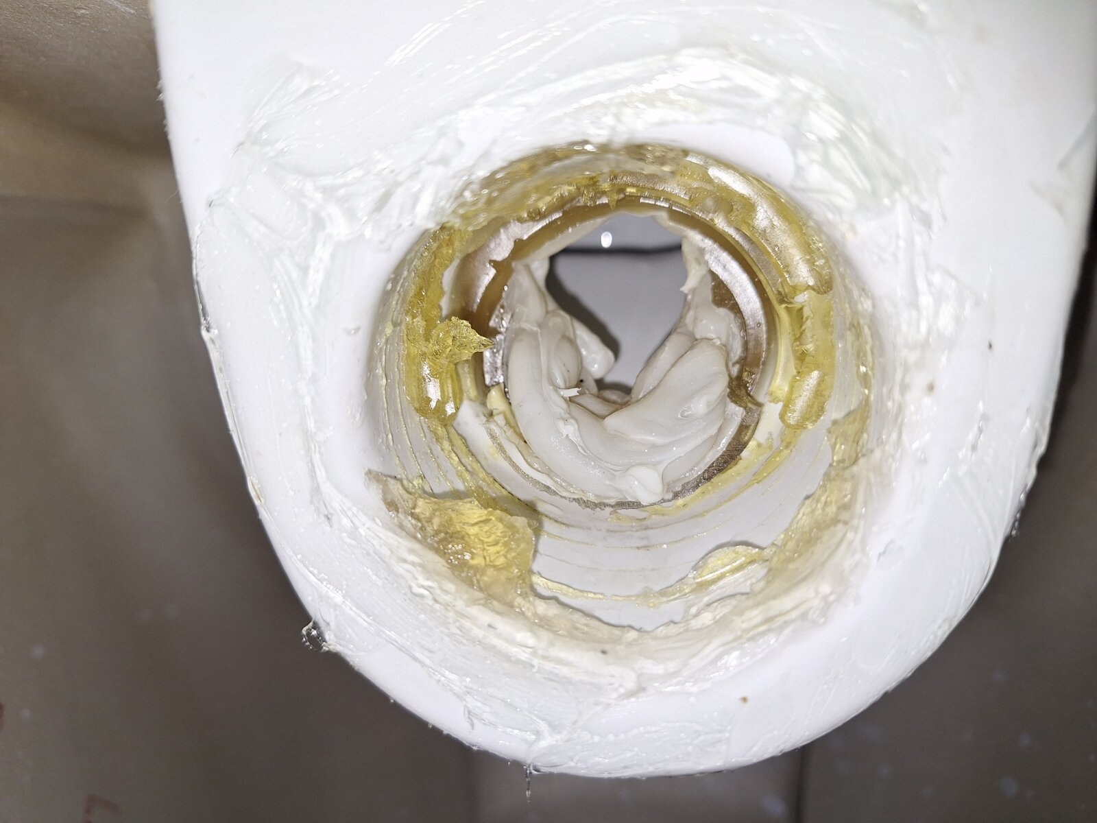

I have discovered and fixed the issue to the weak flush. Water flush inlet pipe was blocked with silicone sealant in back of pan. The flush is now working perfectly.
Sadly, even after sending pictures - the fitter still would not accept responsibility saying it was down to the products we purchased.
Pictures and link to flush below.
NEW RIMLESS FLUSH FIXED
Thank you to all those who helped me get to the solution.
From the previous pics and these it looks like he didn't use a flush pipe bung at all.

Ask him why he used any silicone when fitting the flush cone, on a new install it just isn't needed. If the flush (edit) cone wasn't fitting properly then he needed to discuss that with you and go through options, it's not difficult. I think you need to be firm with him and just tell him there's no point in him disagreeing, it's obvious he was at fault and there's no point in arguing. Really obvious that it's absolutely nothing to do with the products.
