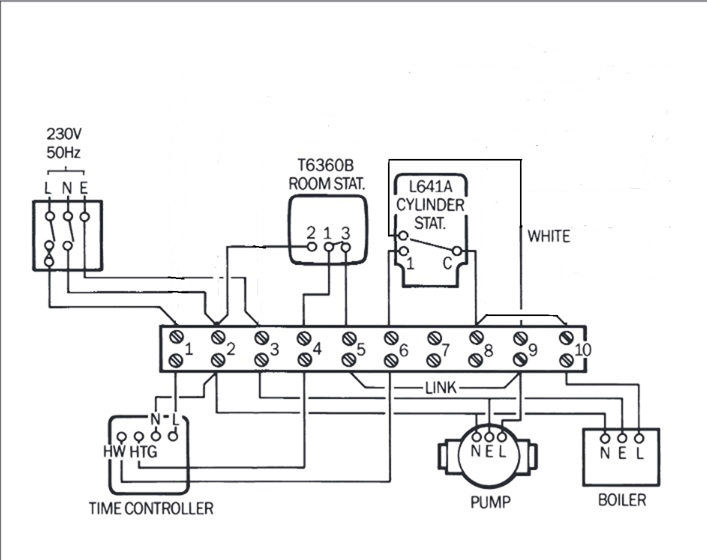

If using the old C Plan then the thermostat only controls boiler and water temperature in the summer, once the central heating is running then it does not control the water temperature.
So have you got a motorised valve? if not than what you have is normal and not a fault, you could fit thermostatic mixing valves to reduce temperature but tank temperature should be over 65°C to stop legionnaires.
With old C plan the tank thermostat was just to stop the boiler cycling in the summer.

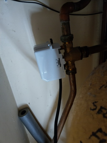

I had to look up C-Plan, but I think I have an S-Plan, with a motorised valve (pictured below). I can independently control my hot water and heating. Does that sound right?

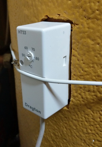

Everything was working fine with the system. I then swapped the programmer unit for a Hive control unit. It was about this time (I don't know if it was exactly the same time) that the hot water went too hot. So I replaced the tank thermostat with a new unit, a Drayton HTS3, which happened to be the same at the old unit, making it an easy fit.
But the new unit didn't fix the problem. You can see from the photo that I have to have the temperature about 50 degrees. This is the point were minute changes make it too hot or not hot enough.

So I'm thinking that the new unit is also faulty (possible) or it's a different problem, but I don't know what else it could be. Any suggestions?
Isn’t a 3 port valve a 'Y' plan? Perhaps with the heating off, the valve is not shutting the hot water off and is constantly heating it when the heating is on? With the hot water set to minimum and the heating on, do both outlets from the valve get hot and is hot water being pumped into the cylinder coil?
You've a got a Y plan system there. I might be being cynical, but you say this problem started about the same time you fitted the Hive? I would wager there's nothing wrong with the Cylinder stat, (new or old), and the problem lies in the wiring. :whistle:

@Motman - Yes, I've been told my system has a Y connector. Is that different from an S-Plan. Too confusing for me! I'll check the pipes to see if the valve is getting stuck. I think the valve is quite new (this year) but that doesn't seem to mean much!

Until it’s fixed, could you not manually move the valve into the heating only position and run your hot water on the immersion heater?

The HTS3 cylinder thermostat has three terminals marked C, 1 & 2. First of all, is there a wire in all three of the terminals?
If you installed the Hive yourself:
Does the wire in C connect to terminal 3 "Hot water on" at the Dual Channel Hive?
Does the wire in 1 connect to the boiler, and the orange wire of the motorised valve?
Does the wire in 2 connect to the grey wire of your motorised valve, and terminal 1 of the Dual Channel Hive "Hot water off"

@stem - I think there were three wires on the thermostat. I'll check later. I copied the wiring exactly from the old one.
