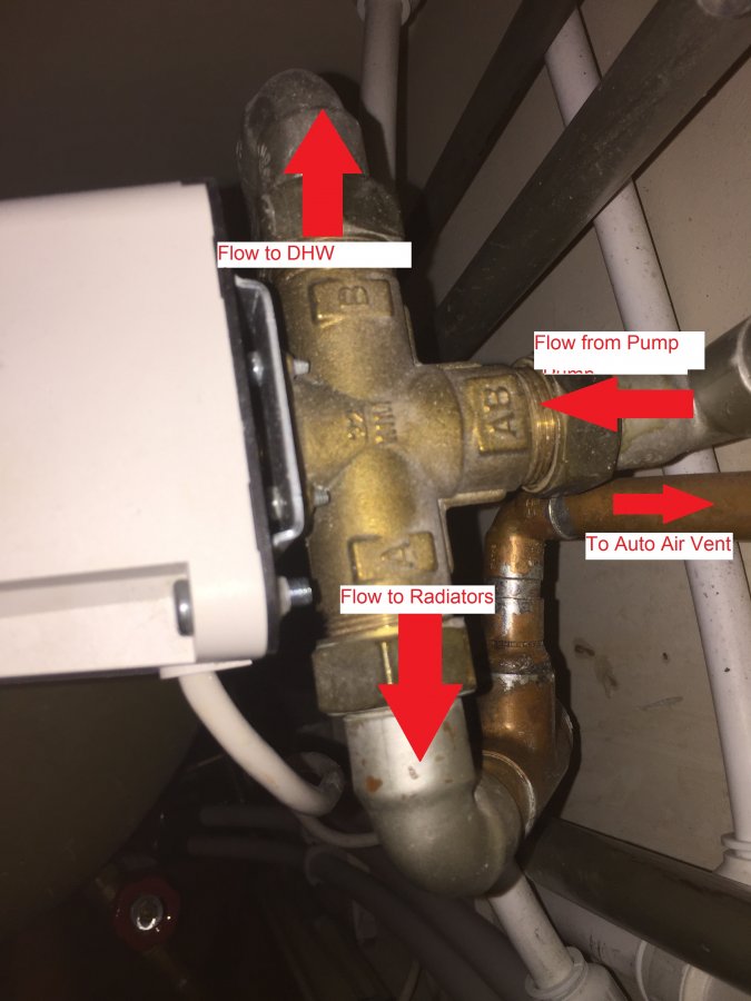

I will get some pics later when I get home but the valve has been removed and checked to see if the CH port is opening as it should do and was. It was exactly the same and the same thing happened with the previous valve which was only changed due to the body leaking where the cam comes out to attach to the head.

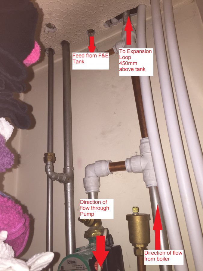

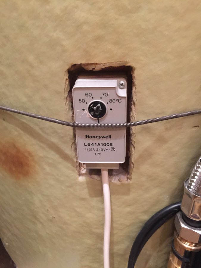

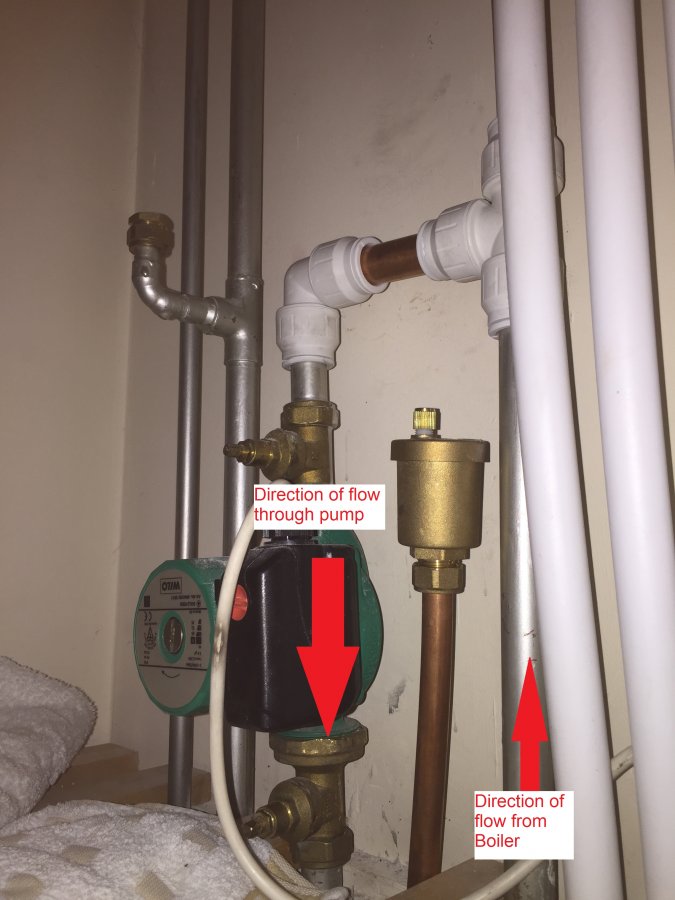

Here the requested pics of the Valve as well as the airing cupboard pipe layout and the Boiler
