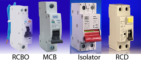

I suspect they are not MCBs, but RCBOs.
At a glance, they can look similar - but the small test button on RCBOs prove the point.
Very likely RCBOs. It's no longer considered the "done thing" to put a whole domestic property on one RCD and for an installation that small the cost savings from a dual-rcd setup vs RCBOs are likely negligable.
Not that easy to tell between MCB and RCBO. Test button is the give away, a RCBO has a test button.

View attachment 295550Not that easy to tell between MCB and RCBO. Test button is the give away, a RCBO has a test button.
