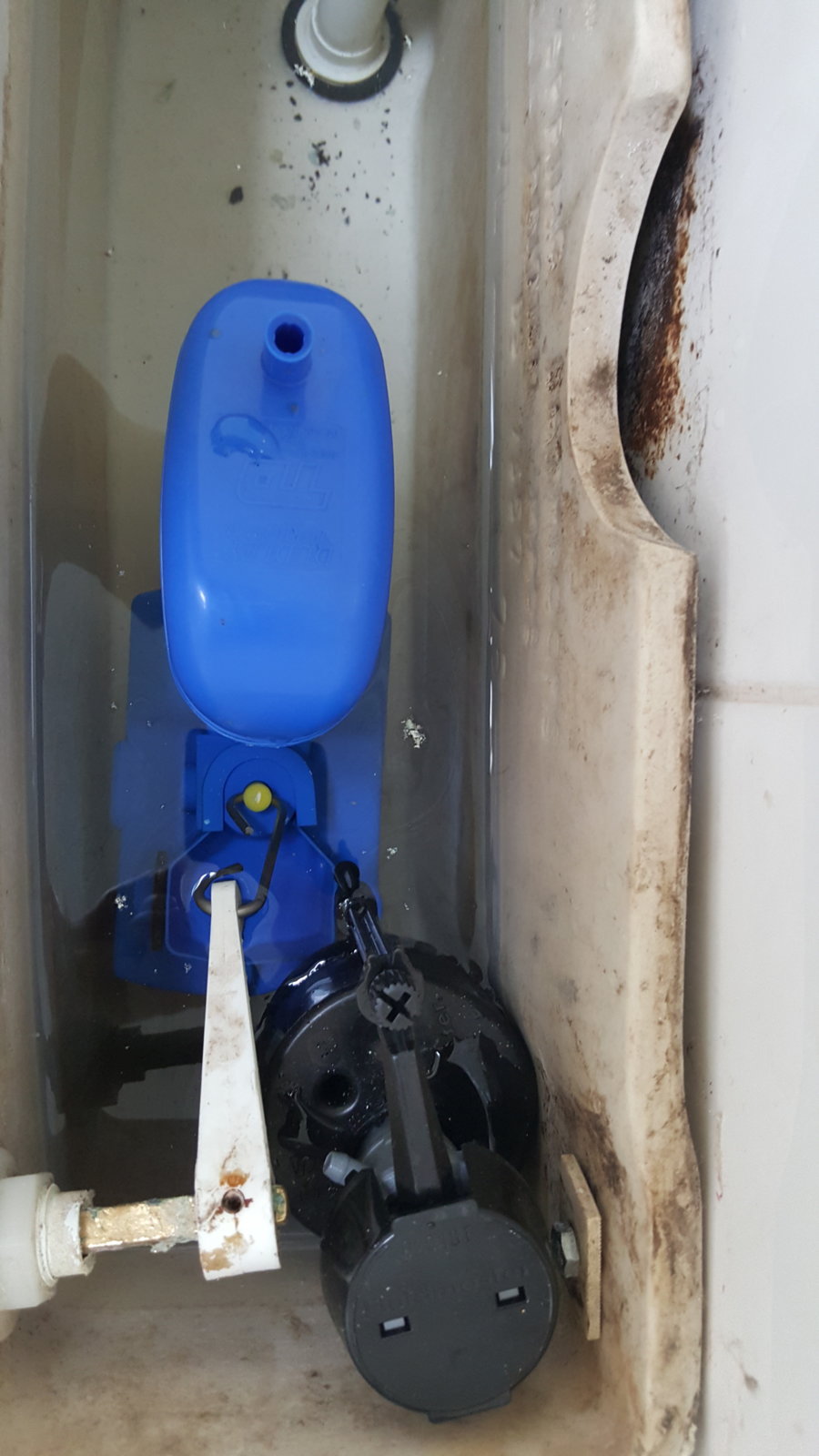

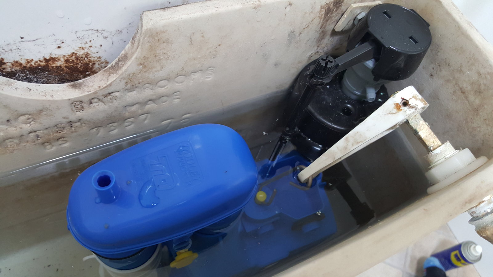

Hi guys
More help please....
I bought the new valve and thought I wa doing really well....even added an isolation valve to the plumbing. But it was very tight going it getting past the siphon, and it just catches, either on the ceramic, the siphon or the flush handle and won't reliably stop the water intake. I've tried it in lots of different positions but can't make it work. The siphon is a dudley t88 which I replaced a year or so ago as the old one dripped. Any solutions? I don't mind replacing the siphon again, but is there one that is likely to be small enough? Or shall I just buy a new one with a ball? Photos attached. Thanks again.

Piece of hosepipe wedged in at the top will move it over so the float floats.
