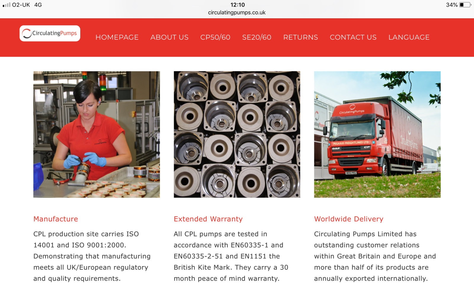

I noticed that and thought it strange. That is clearly a typo. It probably is supposed to be 30 months warranty.
Definitely a typo, other page.....
