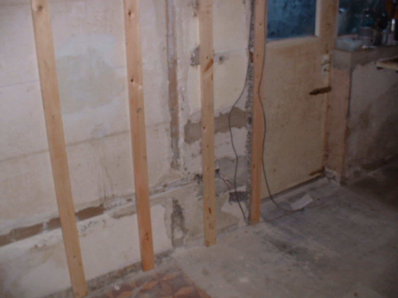

Hi. Council is constructing a false wall on a no-fines wall that has longish two channels dug into it that previously held electrical cables. Workman come today and fitted the battens which will hold some plywood sheet which then will have plasterboard attached. New electrics will fit into this false wall framework.
Question : Although these channels in the no-fines wall will not be seen, covered by the false wall, would not filling them in amount to shoddy workmanship? I asked for these channels to be filled in and the foreman said he's get a plasterer to do it. But, never-the-less, I am curious about whether not filling the channels in would be a case of shoddy workmanship? Thanks for your thoughts on this. Richard

Can't see it making the slightest difference if they are filled or not personally?.
DIYalot,
Channel in wall would not worry me.
But I would like to see insulation between those battens.
And I cannot see any reason for Plyboard to be used under plasterboard (apart from selected areas to later hang TV, or cabinates, or Loo roll holders.
I would (and have) simply put plasterboard straight onto the battens (like all stud walls).
SFK

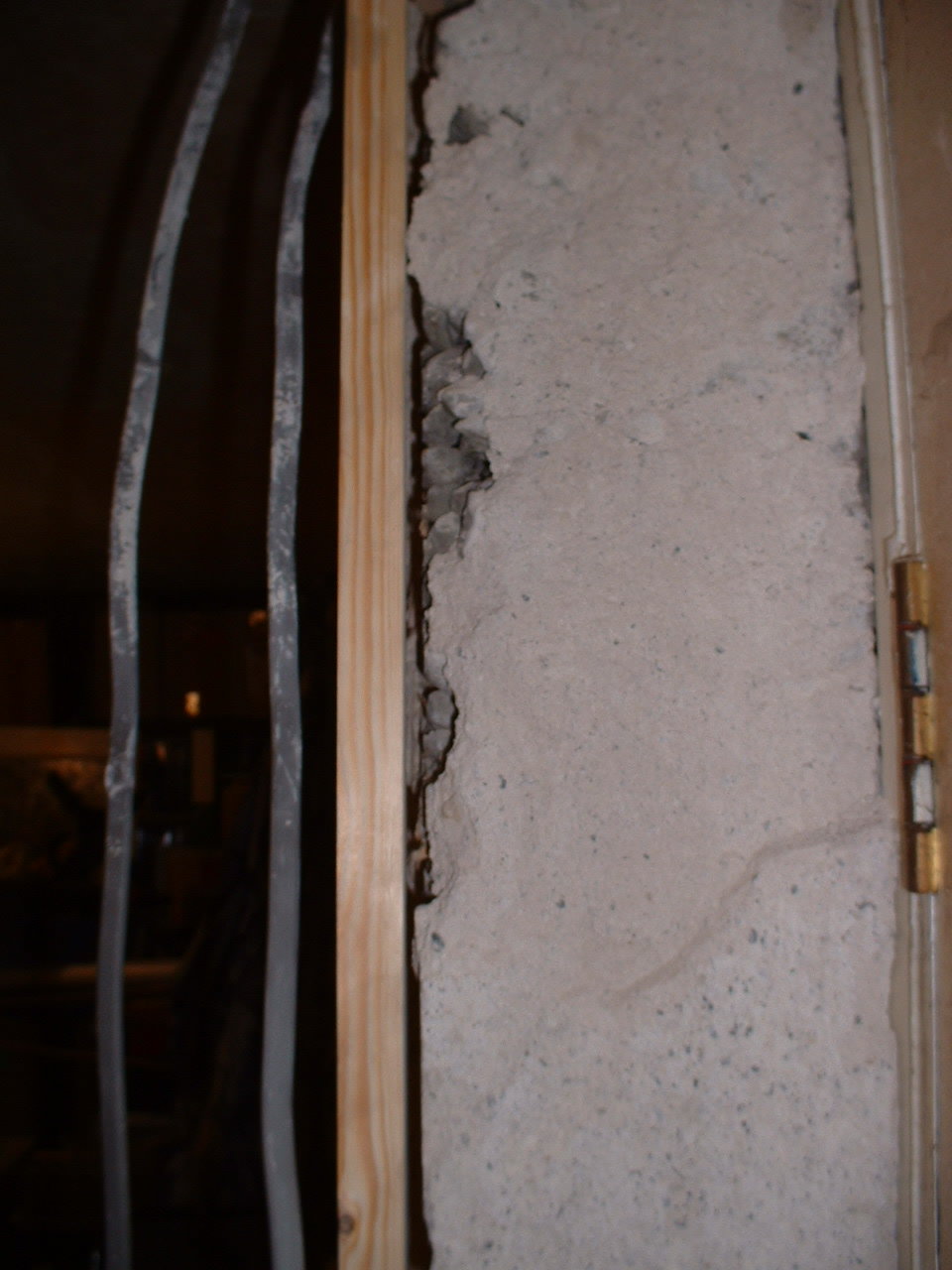

Or: The right-most vertical batten is fixed at the corner. It's just that there is no plaster on the edge, so the batten sits atop the no-fines wall, not plaster. Unlike the other vertical battens. Perhaps it looks like there is a gap there. Mostly not, but I've asked for a re-plastering on that right-most vertical batten. I attach a picture of the batten, looking from the side. There are some gaps to be seen.

@DIYalot if you're a perfectionist I'd be more focused on those battens fixed directly to the existing wall. You are more concerned about what you will never see as opposed to what you will see :).
You will never see timber battens fixed directly to walls by a professional commercial drylining company. The standards are very, very much higher than this. That's not to say this wasn't done by a so called 'professional drylining company'. They can call themselves whatever they want but this is sub par. 'Noddy' workmanship
Why? Because battens follow the existing. If the existing is not flat/out of plumb/straight your new 'cosmetic' will be the same. This is a cheap and nasty solution.
Dot and dab is also a cheap solution but would achieve a better finish.
In this instance, I would use gyp-liner. More expensive but I can achieve an almost perfectly flat, plumb wall. Exactly what you wont have with those battens mate.:)
And back to the insulation - just because you have it outside does not eman you do not need to add it inside if you can - adding it will help insulate more - keep your heating bills down more.
