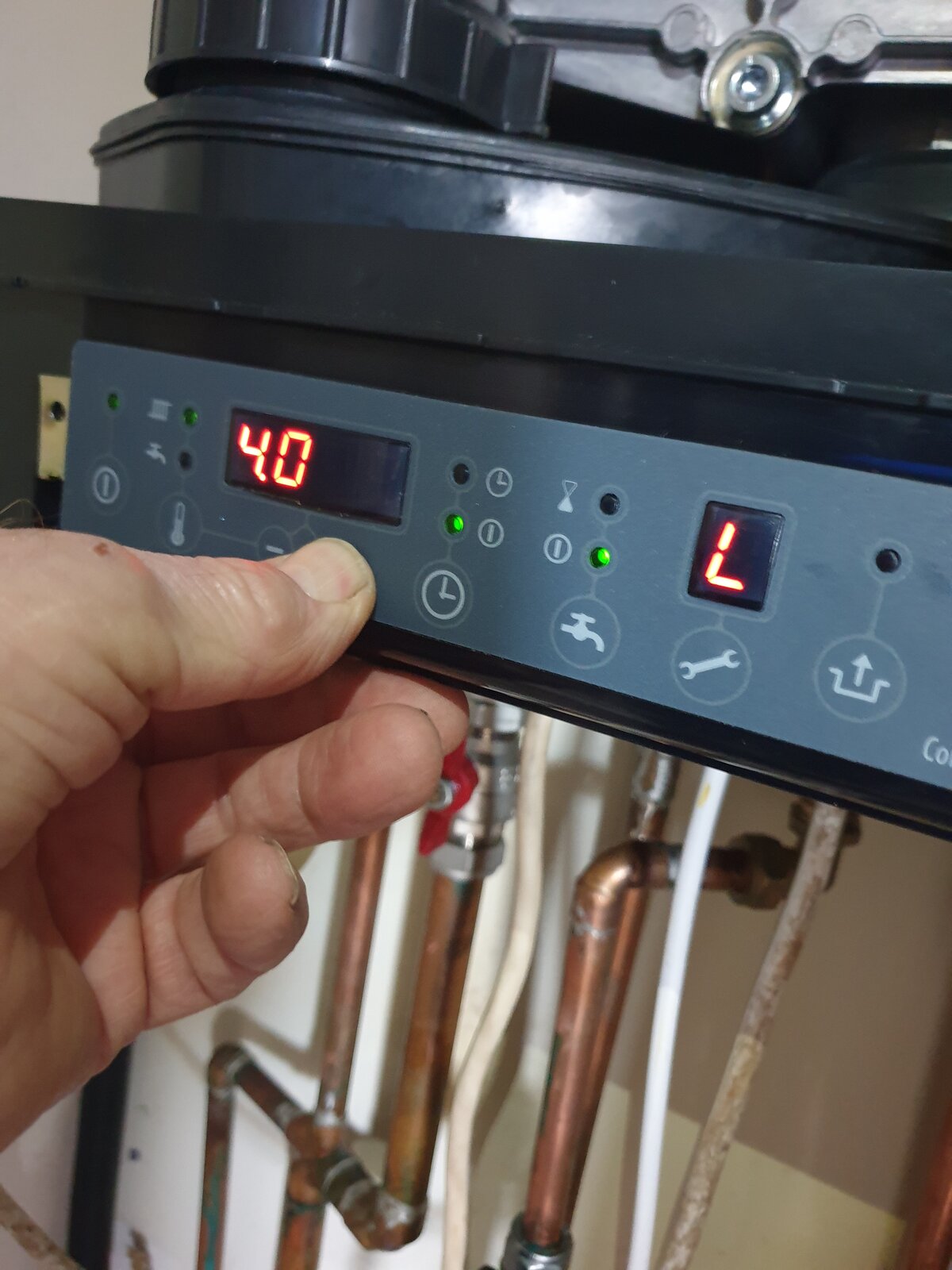

Ionization on the boiler display with it set to L was 4 to 4.4 microamps.

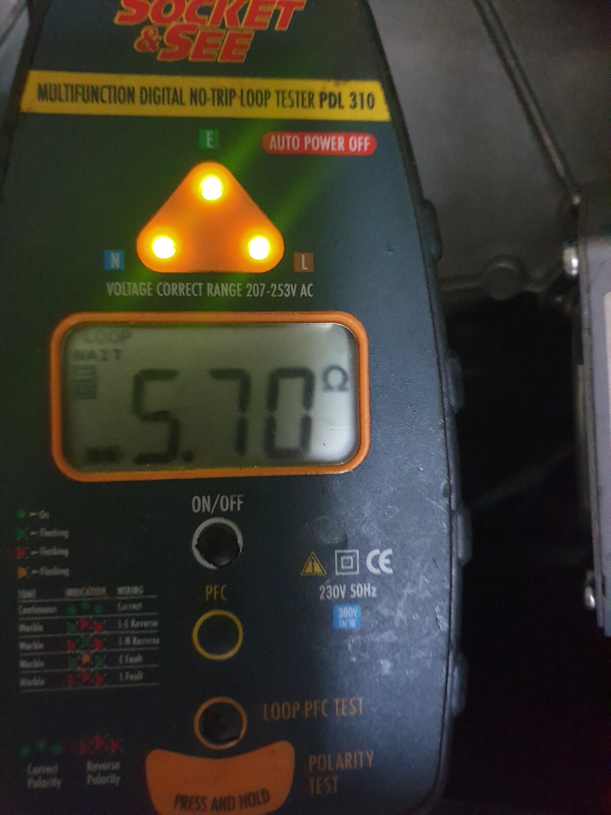

I got 5.7 Ohms on the earth loop tester which was plugged into the socket outlet the boiler plugs into, which whilst its only 70-80 yards as the crow flies, I found out this afternoon that the cable between the Inverter/batteries and the Honda generator which is connected to the inverter actually runs around the edge of the field so me be double that length.
I was unable to figure out size of the cables.
The earth loop tester registered 2.15 Ohms down at the other end of the field

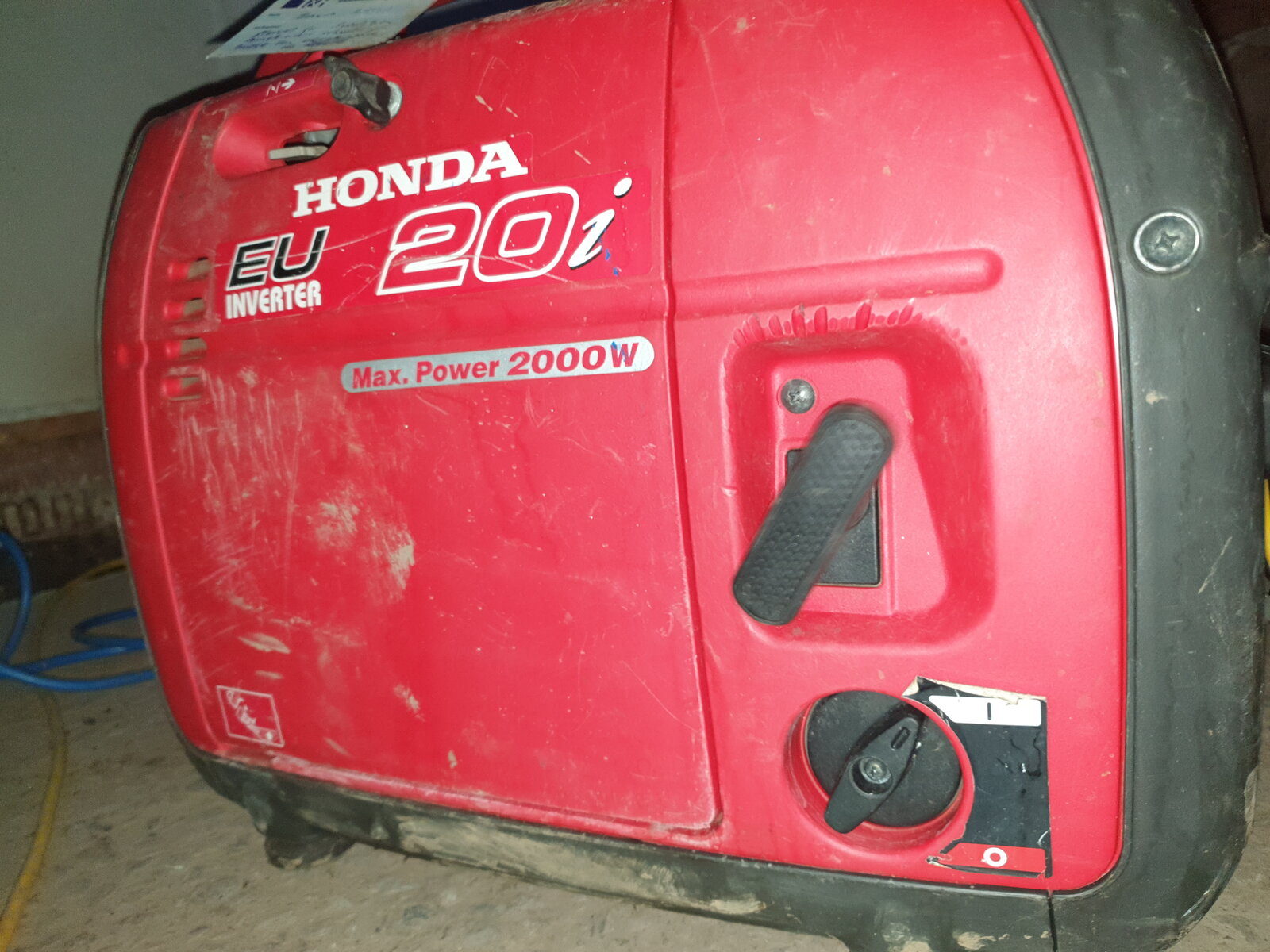

The customer is going to see if her Honda generator will supply clean enough AC voltage to run the boiler.
It is an EU Inverter 20i

I do accept that it may be that the Intergas Boiler may not run successfully on an Off Grid set up
It certainly should be able to, if the supply is configured correctly.
The boiler isn't the problem here, although the boiler is probably unique in revealing the problem with the supply.

Earth loop reading at the other end of the field was 2.15 Ohms at around 4pm yesterday compared to 5.86 Ohms at the Park Home.
One thing I had not realised is that the cable connecting both ends of this installation are longer than I originally thought.
The cable goes around the edge of the field rather than across it.
Therefore it could be twice as long.
