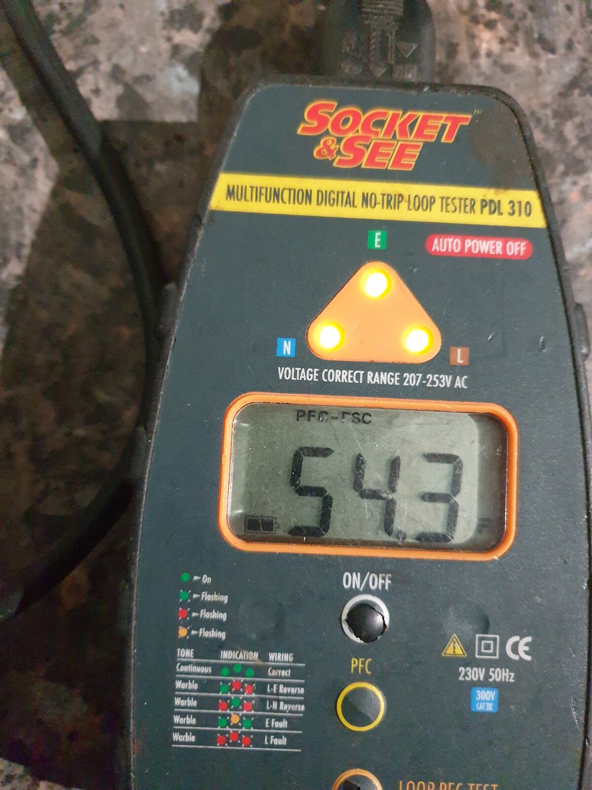

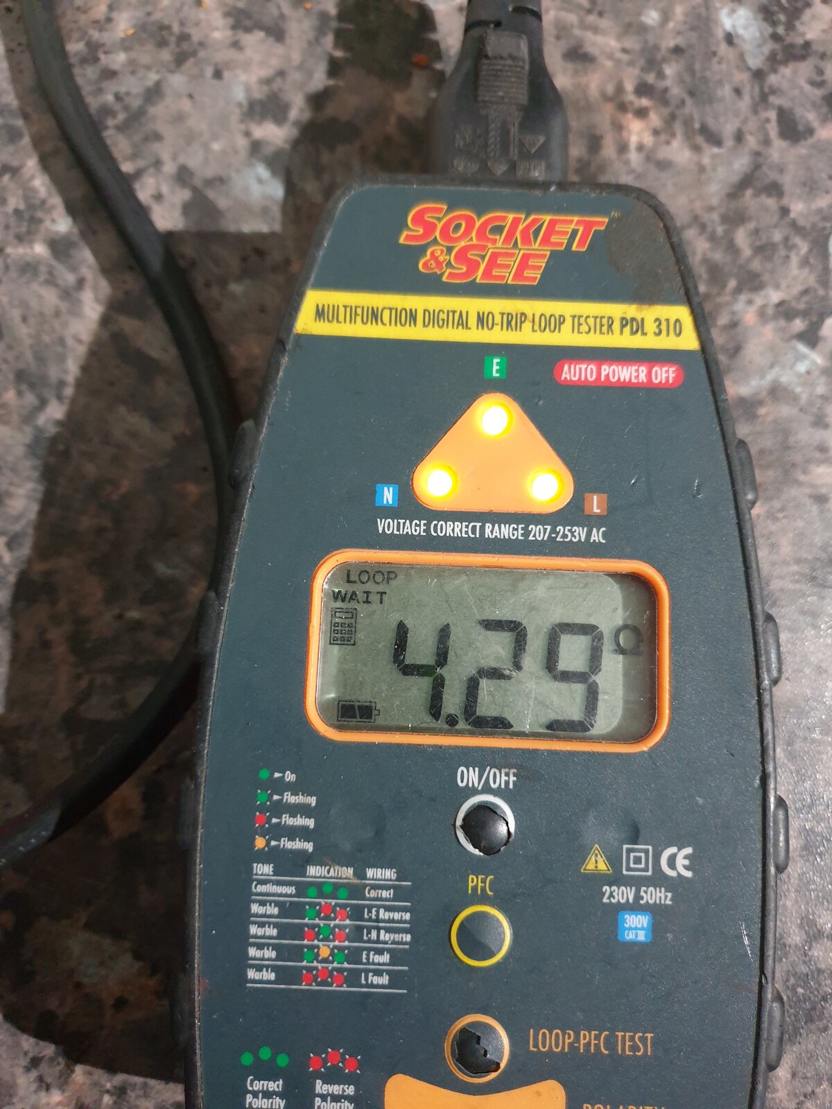

I am now getting 4.39 Ohms on my Socket & See Multifunction Digital No-Trip Loop Tester, its model PDL 310 and 38mb at the new LPG bottles change over valve/Reg and new flexible to the 22mm copper pipework.

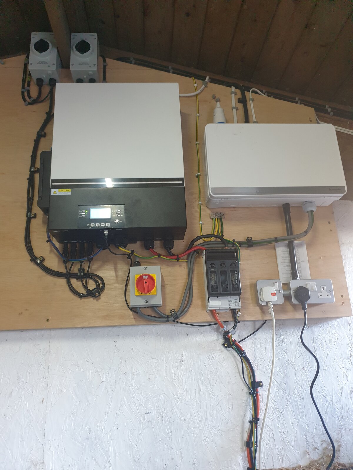

I will post up a few pictures of the Inverter, consumer unit in the Stables end if the installation.
----------------------More to come-----------

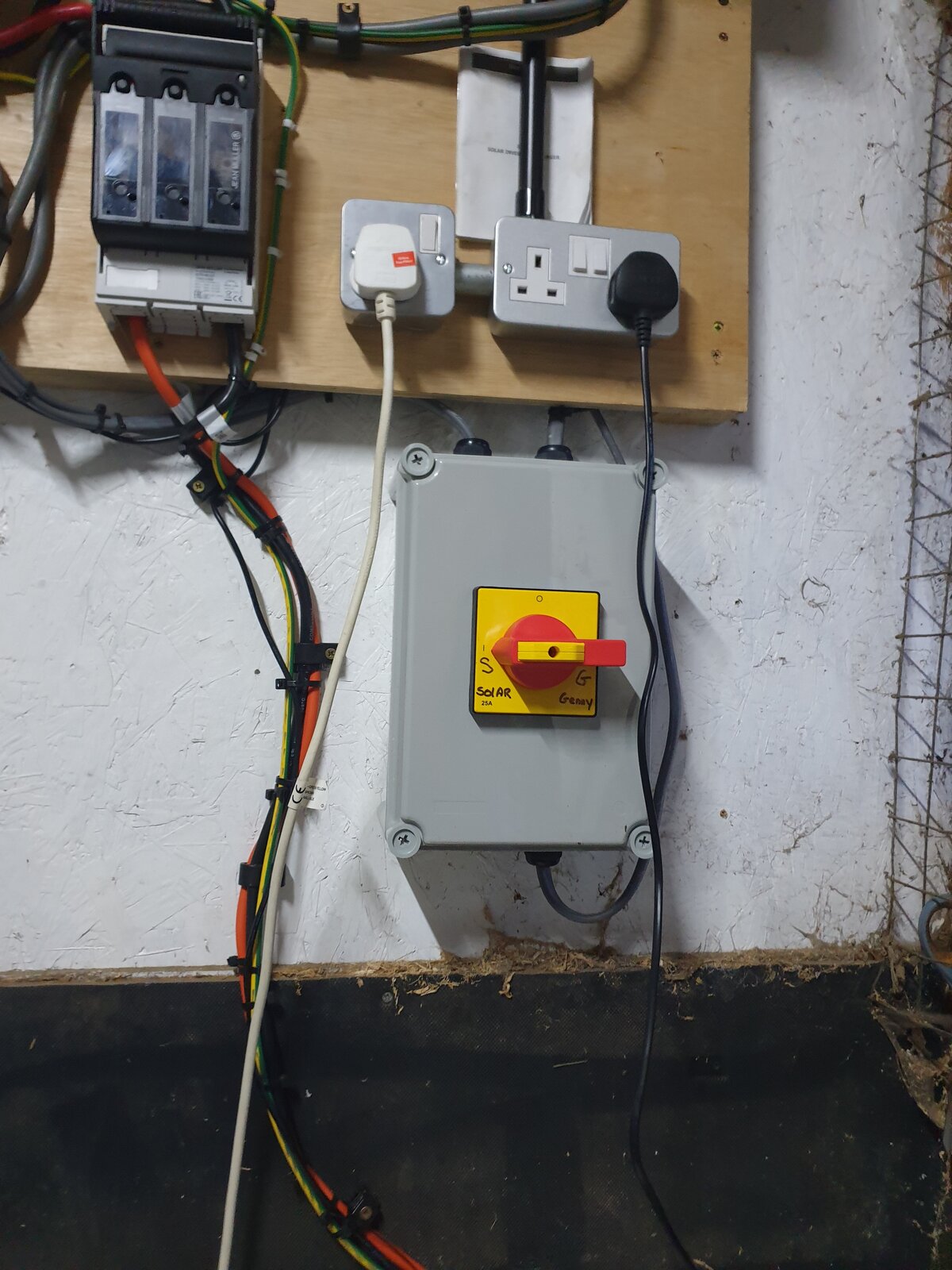

Image 6 which was taken a week before image 5 which shows what I would call a change over switch that allows a diesel generator to supply the Park home if the batteries are low due to not enough sunlight to the PV panels

Would I be able to walk around the place, follow as best I can the path of the earth conductors and get an idea of what’s what?

That suggests it's connected as some centre-tap arrangement, which is not appropriate for boilers or much else.
This is almost certainly the cause of the problems with the boiler, which will probably expect 230V between L-N and almost nothing N-E.
For a grid connected supply 4.29 ohms it's implausibly low for a TT system with a couple of earth rods ,and far too high for a TN-S.
However for a supply from an inverter it's not really meaningful at all, as the supply impedance will be much higher than usual due to the limited current that the inverter can provide.
More useful would be a comparison of the L-N and L-E impedances, but that's probably not something that device can do.
As posted already, this should be set up as a TN-S arrangement, with one or more earth electrodes as an earth reference for the supply.
Possibly, but the main problem is most likely how the inverter has been configured/connected.
It would also be useful to know how the generator supply has been configured as if one of them is wrong, it's likely that they both are.
Or worse, they are configured differently so the earthing arrangement changes depending on the supply.
The general untidy arrangement of the inverter and cabling doesn't give much confidence that any of it was installed with any attention to detail.
