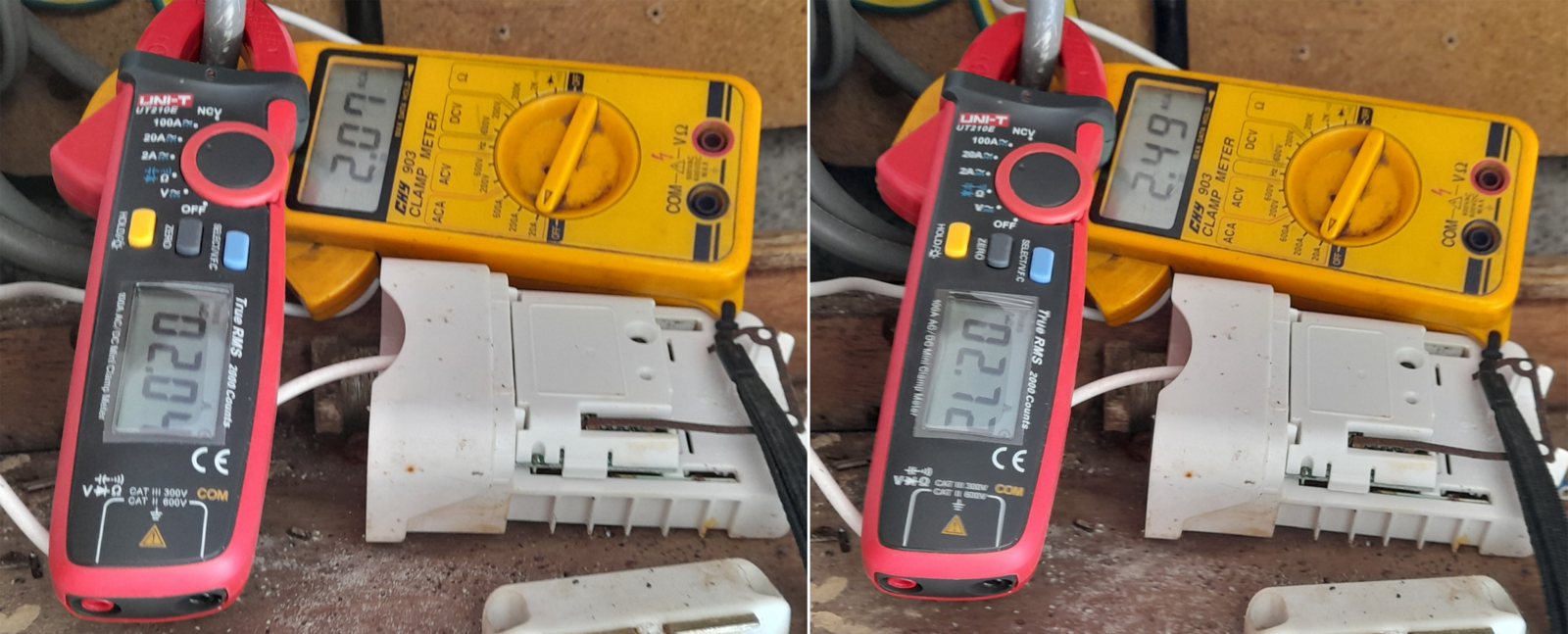

My attempt to measure inside the boiler current used did not work, too much needed to be dismantled, so did whole house.
So left meter 2.72-2.04=0.68 amp right meter 2.49-2.07=0.42 amp left meter newer and right meter jaws are stiff so will go by left meter, so 156.4 watts which seems to line up with the 155 watts the installation instructions say, plus pump and motorised valve.
I did repeat a few times in case some thing else stopped or started, I don't have a smart meter so I have to manually measure, I suppose these people with smart meters can clap their hands and get reading direct on their PC, the white box use to do that, but the batteries leaked.
