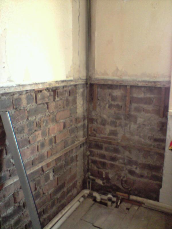

I've studded out 1 of my bathroom walls to hide a shower valve. It's an outside brick and stone wall. There's an original stud wall, of lathe and plaster maybe 60mm deep half way up (photo attached). My new stud wall is 89mm (CLS 4x2s) deep.
I have an abundance of old polystyrene tiles I'm removing from various ceilings.
Would putting these tiles in this new cavity be a good move. My gut says yes.
thanks for any advice.

The pic wasn't informative - is it the correct pic?
AAMOI: the skirting in the pic is carrying a 15mm supply to a WC (?). Why not use this refurbishing opportunity to drop that supply, in plastic, below the floor boards?

And what is the fire risk in sealed dry-lining, against an external wall with plasterboard fire protection ....... and in a bathroom to boot?

As Woody picked up, the proposed place for these old tiles is a sealed drywall cavity to an outside (North facing) wall.
I want to protect the pipes against the cold. I'll be running new shower pipes in the cavity (no Electrics)
