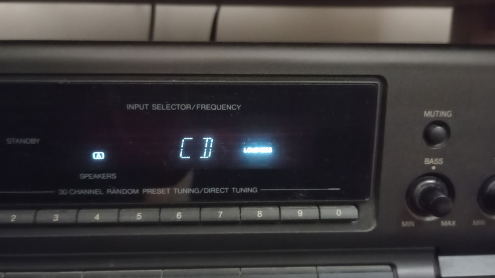

I have an old Technics amp (SA-GX190) that has suddenly gone into steroid mode!
The display now shows that a 'loudness' option is activated, and the volume/bass response certainly gives a total change in output!
The problem is I can't find anything on the amp/remote to control or turn on or off the 'loudness' feature.
Whatever audio source I choose makes no difference, and a power off has done nothing.
Any ideas as to what I can do to solve this, as google so far hasn't come up with anything that works.

Can you post a pic of the display?
That definitely seems a bit odd, as I can't find any references to loudness in the manual.
See pic below (apologies for the quality)
Also I saw that link, but as you say no answer.
And I haven't changed a thing as regards the setup and didn't use the remote to power on or change any settings.
Edit: But to give you an idea about the audio output change, whereas a 6 on the volume would normally fill the room a 4 now does the job.
And I can reduce the bass using the relevant knob, but just want to know why this trustworthy old amp is having a mid life crisis!

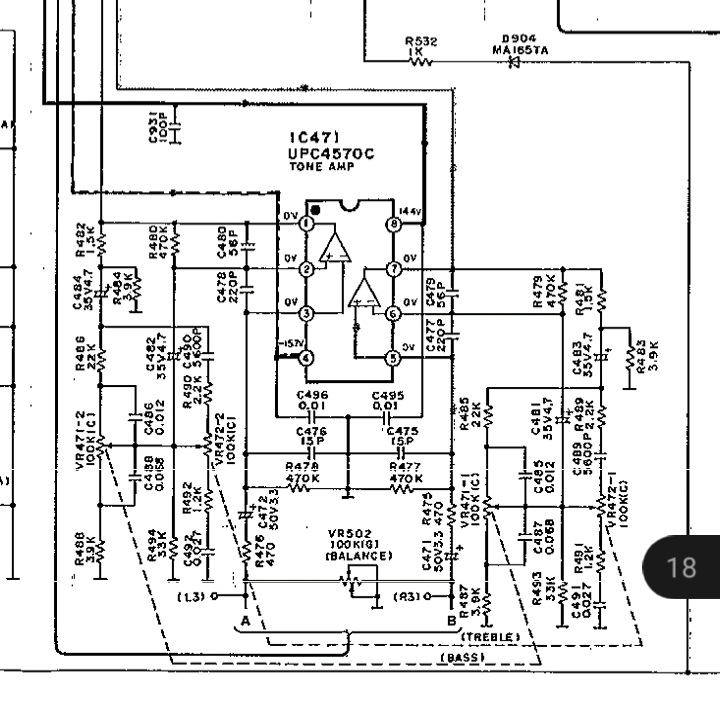

Apparently the SA-GX170 is almost identical to yours - the service manual is easily found (there is only a 4 page addendum updating the schematic to a GX190).
Looking at the schematic, the tone amp circuit is a completely self contained system, only the treble/bass/balance knobs effect it.
No other electronics are involved - i.e. remote control button presses won't effect the tone.

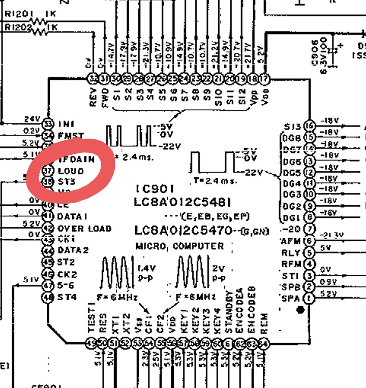

Which led me to the main controller IC...
Which has a loudness pin, that shouldn't be connected.
So, I'm guessing that there could be a slight short to the pin/PCB corrosion, or something internal to the IC may be a bit squiffy!
The only thing I can suggest, without delving into the electronics - unplug the amp, and short the plug pins on a piece of metal (screwdriver etc.), and leave it like that for a good while.
It's just to try and drain any capacitors of their charge, and hopefully allow the IC to reset itself.

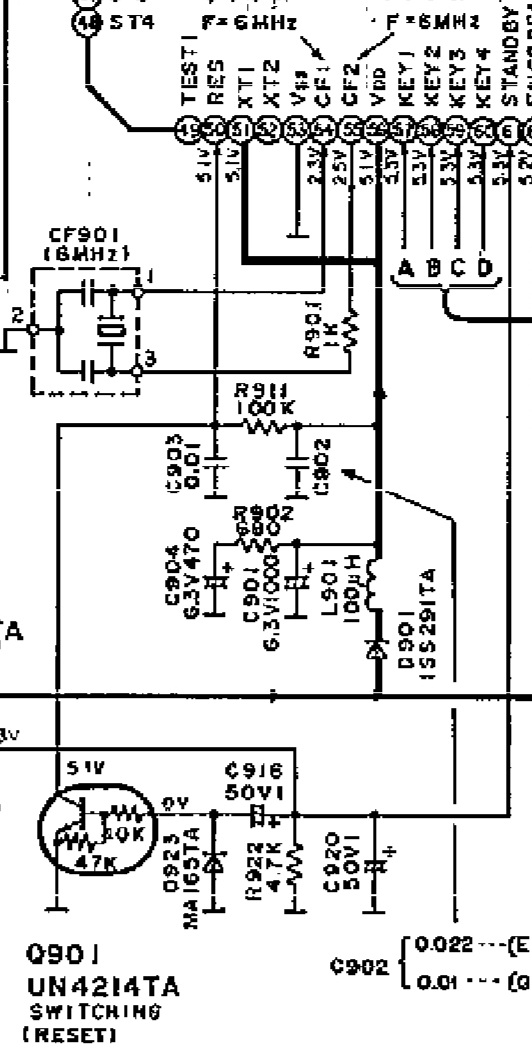

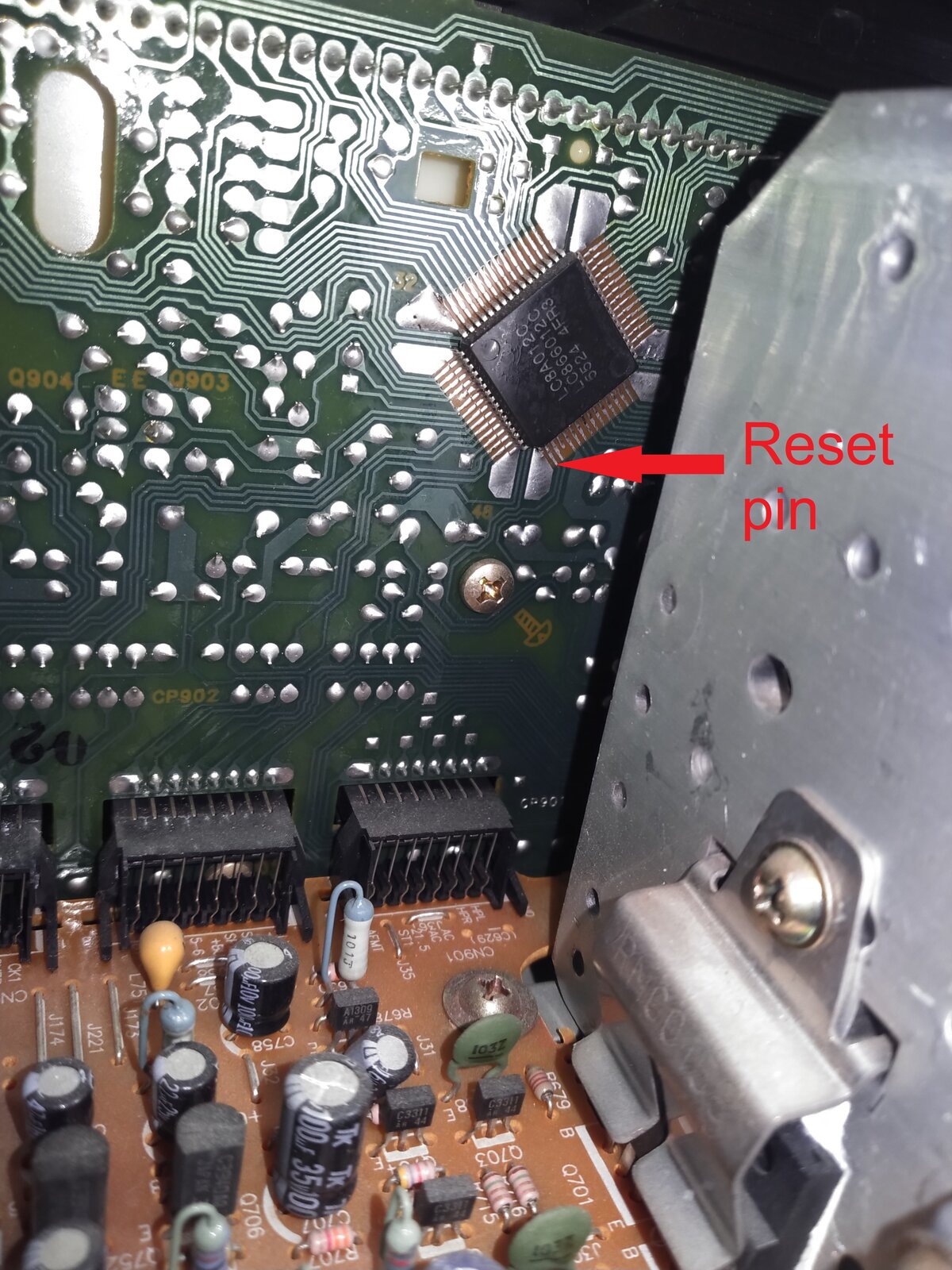

Hey ellal, have you been successful with getting rid of the "loudness" label yet? I had the exact same problem on my SA-GX170 for the last few months and after reviewing the service manual on pages 13 and 18 (of the pdf), I found out how to factory reset the main computer and it got rid of the loudness light for me. It requires steady hands, but what you do is locate pin 50 on the computer within the amplifier. This is the reset pin. Then what you need to do is use a wire and ground the pin for a few seconds (touch the other pin to the heatsink nearby). If you are working on the amp while it is turned on, the amp will shut off while you do this and reboot after you are done holding the wire in place for some time. I have no idea how the amp ever got into "loudness" mode, perhaps a power surge or some electrical anomaly caused it to happen, but at least it's gone for now. Looking inside of this amp really gave me an appreciation for old amps like this. I've recently tried to work on a modern Pioneer amp for a friend and there is no service manual or documentation to help you fix it.

It's a little bit poor, the loud pin is just floating, and not tied to a rail - some stray capacitance or corrosion may be all it takes to turn it on...

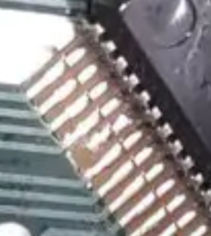

It may have been slightly easier to find the next solder pad along the track, rather than try and ground the pin itself - there would be a far lower risk of anything going wrong.
I had noticed the reset pin, and it's connection to standby, which was why is suggested shorting the plug pins, but now we know the system can do a full reset on that pin, I'm wondering if a (very) long press on the standby button (when the amp is on), may initiate a reset? - the circuit diagram seems to show that it "could" work that way.
I never even noticed that, yes you could use the third solder pad directly right of the screw below the chip to do this too.
I'll have to program some stations into the tuner and try this tonight.
After trying to hold the power button down for a very long time, I can't seem to get it to factory reset that way, so the "grounding the reset pin" method seems to be the best option for resetting the computer.
