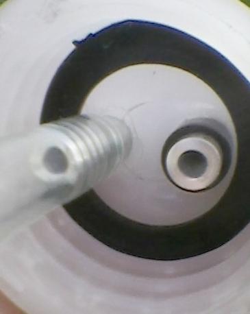

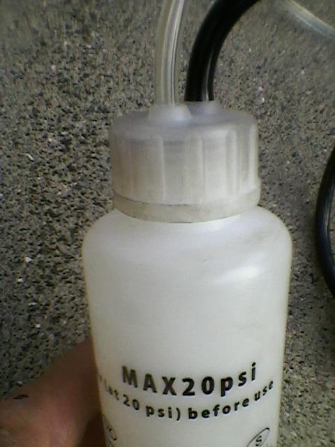

The Gunsons Eezibleed I got from ECP is faulty!
I was going to start with the rear drums. The n/s nipple broke off so took the the drum off to take a photo of the cylinder and it was shot. The shoes were covered in fluid so a complete refit needed on the rear. Got that done and thought I was on the home straight.
Dropped one of the tyres to 19psi to use for pressure, hooked up the Gunsons and it started hissing air out of the pipes set into the pressure bottle's cap. I checked the pipe fittings in the cap but no go, its faulty, so back to ECP it goes.

I feel your pain. I gave up on pressure bleeding and now use vacuum/suction but as said before it does need a compressor
Had a look at the Eezibleed this morning and managed to get a slightly better seal on the bottle's pipe connections. Basically I pulled them off, cut the pipe ends back a bit and pushed them back on to the metal glands. The sealing relies on the pipes tight fit into the bottle's lid. Still got a bit hiss of air when pressurized though. The product could be so much better with little effort.
Used it to bleed the rear cylinders. Having been left overnight with reservoir cap loose seems to have gravity bled the pipes on to the master. Went for a test drive and had good firm brake pedal.
