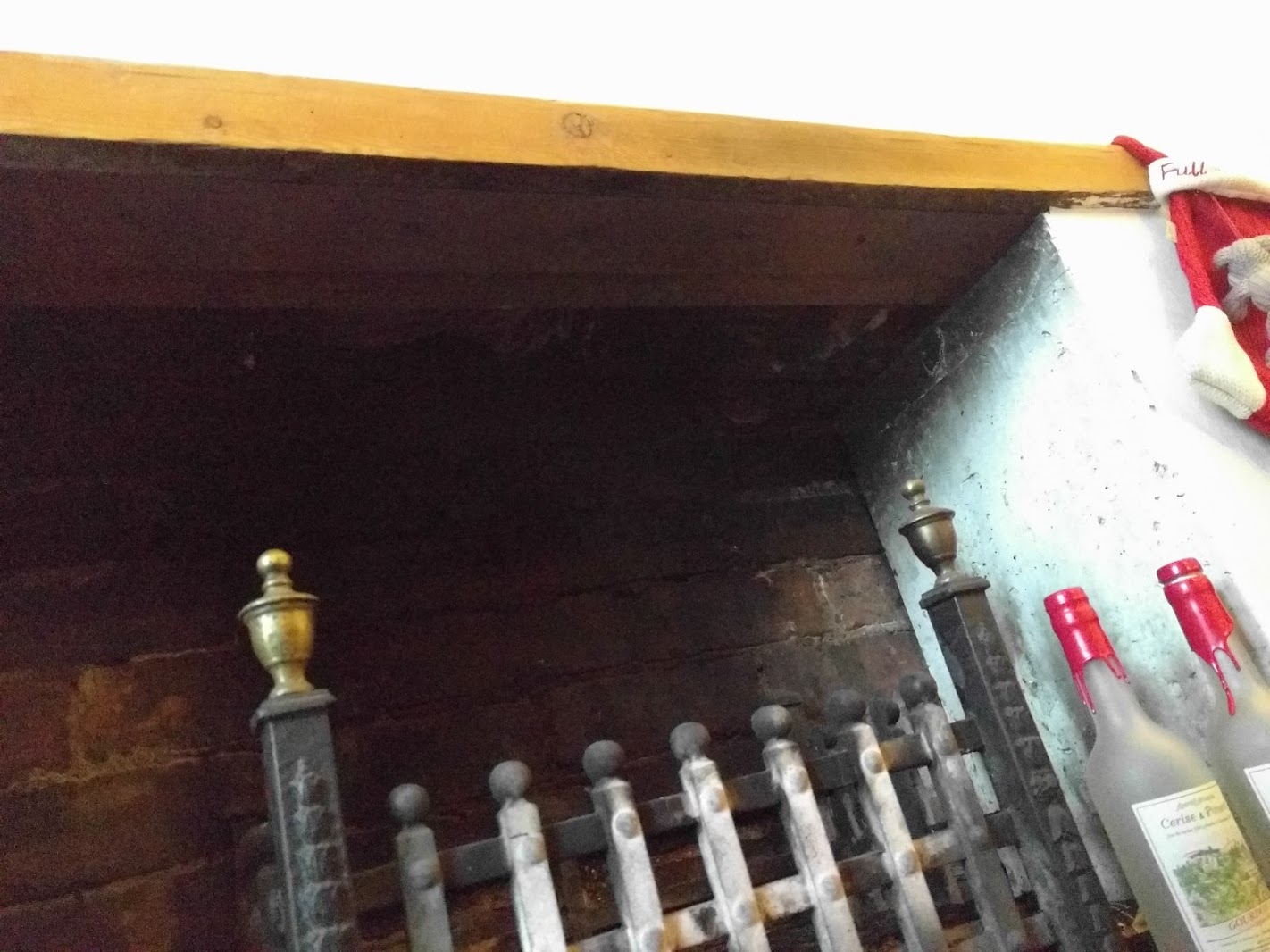

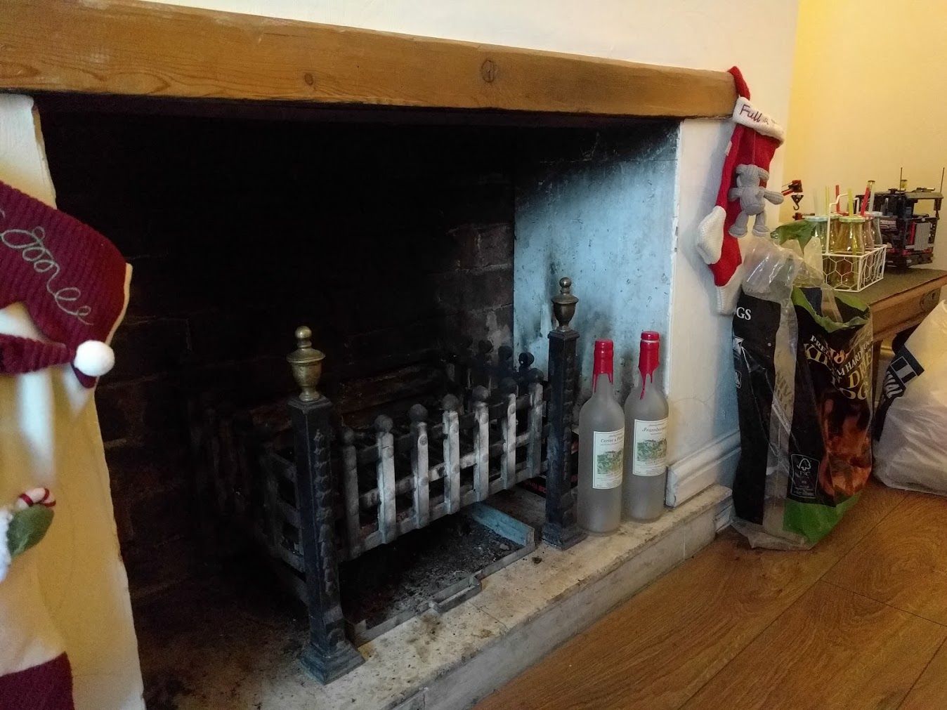

We recently bought a house, which has an open fireplace in the dining room, with a wood beam above it. We've not used it since we moved in, but the previous owners did.
The chimney sweep advised against using it until we have "fireproofed" it. At the moment, there is just a sheet of steel on the underside of the wood beam to protect it from hot embers. But, that obviously doesn't protect it from gradual heat build up, which I assume could cause a fire on such a dry piece of wood.
One suggestion was to add a fire brick to the underside of the wood beam, to protect it from embers and heat. Something 25mm thick wouldn't really be obvious to look at either. Is this safe?
Are there any other safe suggestions? Other than, "don't use it", "replace with concrete" or "fit a wood burner instead"? The latter would be a possibility, but at the moment is something we can't afford, and I do like a nice open fire.

Your pic suggests it is a dog basket just used for decoration rather than burning & on that basis the only thing you can probably use it for in it's present condition would be to house an electric fire. Only a site visit by someone qualified in the heat medium you would like to use can give you definitive advice.
That does look quite low. It may be the picture. Do you have room for a log burning stove? It will be much more use than an open fire and a lot safer.
Does not look like it was used for an open fire , the basket is too large and there appears to be no hearth?
call a gas safe for safe options an a quote.but unless you have definit ideasit can only be a rough quote.some sweeps are gas safe an good fitters
It has definitely been used as an open fire by previous owners. I know this because they told us so, there were ashes in the basket, the brickwork is sooted, and the underside of the wood is also a bit charred.

I've attached a couple more photos which show it better. Previous owner put a thin sheet of steel on the underside of the beam to "protect it", but obviously heat transfers well through steel, so I'm not happy with this solution..
So based on the size of the bottles its under 600mm high. Its going to require a lot of work to make it comply with current fire/building control needs should you wish to bring it up to spec.
It might be worth looking at an inset or cassette stove instead. Not going to be cheap, but 100 x better and safer.

My house was built in 1920, I installed one of my fire places before the regs came in, the other was done after the rules changed. I'm afraid your surveyor IMO should have picked up on the fire place as there is no way this was built pre-regs. At a push maybe late 90s, in which case you might have got away with it.
To make it safe, you need to think about Fire control, combustible surfaces as minimum. Open fires just can't be made safe in my opinion as you have no way to shut the oxygen off, so you cant do anything to control the burn say, when you go to bed. In that case its about having non-combustible surfaces within spitting/sparking distance. (1.5M).
