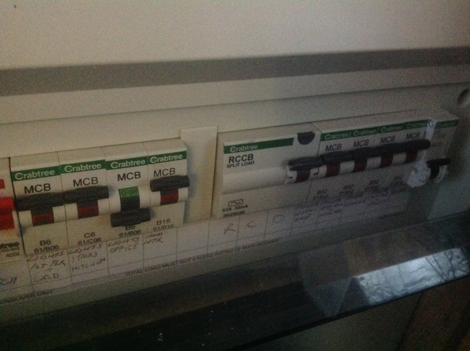

It's raining again and the MCB has tripped. This is with the light fitting removed and the cable in a connection block and taped up.
It's an MCB, see attachment. However, am I right in saying that the 4 circuits on the left are not protected by the RCD which explains why the RCD is not tripping?
Then, I would think the fault is elsewhere and the light you fitted is a coincidence.
You are correct.
Not necessarily. They react to different faults.
Now we know the light was not covered by an RCD, it could also be an L to E fault or still L to N.
