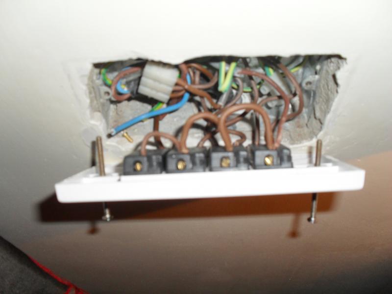

Why is that blue wire floating free from a terminal?
That is from the cable which is going outside to my lights!
Then apart from this all I can see from the picture is live and switch live with cpcs in the background - as fireman22 said you will not be able to get these outside lights working without a neutral.
<a photo of a horrible mess>
Make very sure you make a note of where each and every one of those wires goes before you remove them...
That loose blue is worrying, as is that screw that's lying there - where's that from?
As others have said, you'll need a neutral for the lights to work - you should click these before doing any more work:
thats ok, well you need a neutral connection, is there a socket outlet under the 4 gang switch or nearby? you may have to feed of a socket then take a switch wire up to your 4 gang switch, or just switch it from a spur unit alongside the socket your feeding off
is there a socket nearby

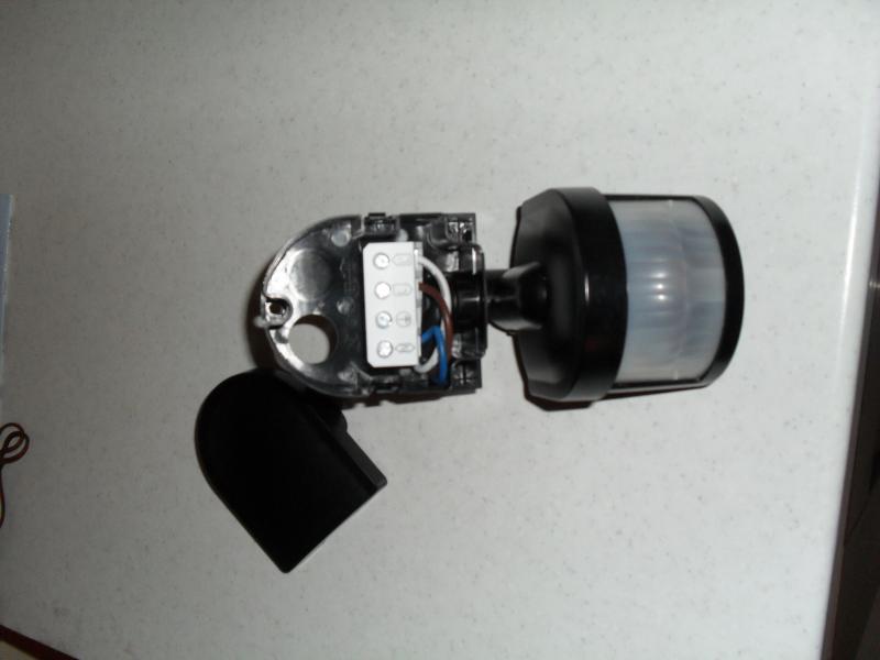

this is a pic of the inside of my switch, you can see the black cable to the left hand side which is going outside for the external lights!
Can't see a black 'wire', assume you mean the unconnected blue.
Are you certain there's not a neutral block hidden away there, probably consisting of a bunch of blue wires? EDIT just seen you said there isn't.
Whoever wired that switch up went to a lot of trouble to do it badly.
How is this wired?
There seems to be only one permanent live coming in (far right).
The other three switches are linked to this.
Only brown wires are visible.
Has someone used twin brown & earth and so could that connector be Neutrals? If not what is it?
Can we have a clearer picture and show what is coming out of the grey sheath?
It looks like some of the cables may be insulated and sheathed singles.
Perhaps there are twin and earth cables which have the blue core cut out. If so, there may be a way to get a neutral.
Are there any spare/unused/cut out wires there?
Bearing in mind the cables are relatively new, and that there are so many of them, it's a little odd there isn't a neutral there.
I can see at least 3 T&E in there with no neutrals showing.
Whatever it is its a mess.

We got a neutral as the outside lights could not work without a neutral!! The original so called spark had left a twin brown cable with a brown cable not connected to anything but the other end was one of the brown cables in the terminal block you can see in the picture so, we connected the end of that brown cable to the neutral in the outside connection and split the terminal block to have the other end in the switch as the neutral connection.
