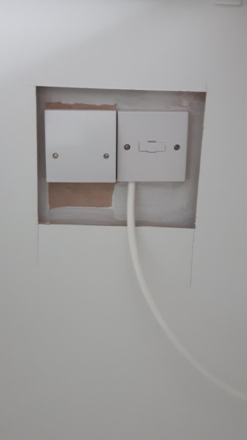

Hi Guys,
I have 2.9kw single oven on 13amp hard-wire, spurred from cooker outlet.
I'm looking to purchase induction hob which also requires 13amp hard-wire...is this possible, how many 13amp hard-wire spurs can you take from cooker outlet (rhetorical).
Am i restricted to selecting hob with 32amp hard wire?
as i understand it, ovens and hobs need to remain on the dedicated cooker circuit, seperate from ring main...or is this incorrect?
advice welcome before making wrong purchase.

If you have a cooker circuit that has cable size for 32A supply. Then you will be fine to install a second FCU or a double outlet plate.
But I would have thought most induction hobs would exceed 13A?

Cooker circuit is 10mm and 40 amp protected. okay, so i can provide second FCU from outlet, attached picture of current sockets.

The regulations allow for more than one connections at the cooker outlet plate, so is feasible that an oven and a hob can be connected at the same plate using a dual outlet. This is not uncommon.
Rule of thumb is a cooker circuit with 6mm cable (providing no correction factors/deratings) witha 32A breaker can supply up to 15kW.
You have 10mm cable with a 40A breaker. Your demand is much lower than 15kW and the current draw would not be an issue.
