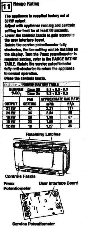

I have a Glow worm hxi30 2 years old. Definely too big , my gas usage now 25% higher than before when I had a nettaheat 16/22. Consumption monitored over 4 years.
Can I downsize this Glowworm with software? Who can do this for me?

First work out your heat requirements for the house, eg Megaflow 210 has a 21Kw heat input.
Then follow this
[/img]
Your control will look diffent to this but the principle is exactly the same ;)
