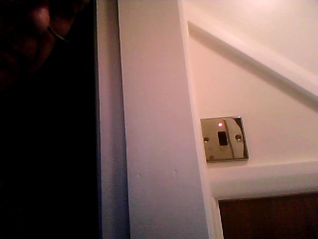

Hi all, we have no light in our ( under the stairs ) pantry at the moment so am looking at running one in that comes on with the main kitchen light, do i have to run this extra light from the ceiling rose of the existing light or can i go from the more convieniently placed light switch which is placed directly in front of the pantry. Cheers
if there is a neutral at the switch you can run from there. pics of the switch connections will help.
I can't provide pics just now, there is just one cable running to the switch connected to L1 COM and earth
L1, COM and earth suggest there will not be a neutral available, just live and switch wire. Your only way would be to go from the kitchen ceiling rose, unless there is somewhere else? Is the consumer unit in there, by any chance? Any power socket at the top of the stairs?
Might a battery powered wall light be enough for such a small space?
There is a power socket in there, we were just hoping we could run it to come on with the main kitchen light, never mind, many thanks for all your help
