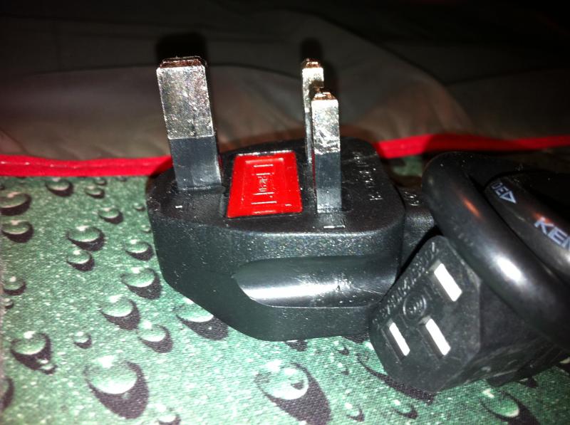

At least mine has a 13A BS1362 marked fuse in it :p , (although it doesn't have any ASTA or BS kitemark marking).
