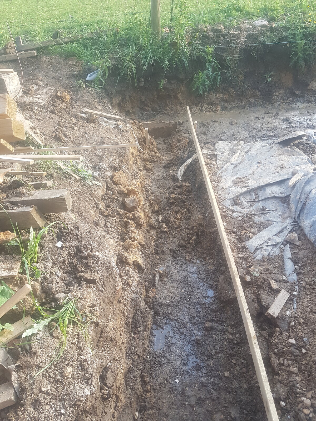

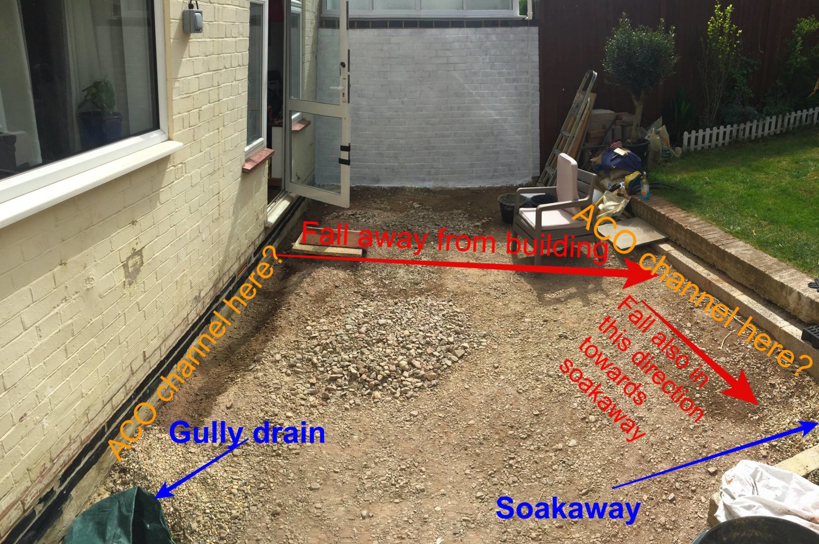

I am after some clarification for Aco drain location. I have attached two pictures to show the Bifold doors which will have a sandstone pation with a fall toward a retaining wall.
The sides of the patio will be flanked by the side of the garage and then another small garden wall.
Originally I was planning on drains at the sides of the small walll and garage and then finally one at the bottom fall where the large retaining wall is. I dont think there is any need for one under the bifold if the fall is OK?
Is this overkill? Do I just need the one drain at the bottom?
The area is about 35m2 soakaway is connected at one end of retaining wall at bottom.

I am just thinking is it a better job to put aco drain on all sides of the patio and cememnt /tuck them in to the sides with the sandstone?
If I did this would I set the aco drain in when I do the wall foundation which I was going to have finish just before finish floor level and then brick up from here? I don't want to put the footing in and then have to cut a channel for the drain after!

I don't really understand, maybe a sketch with some arrows would help. But surely the falls you lay the patio to will determine exactly where the channels need to be. Have a look on "paving expert.com"

I was looking at this thread https://www.diynot.com/diy/threads/new-patio-where-to-lay-aco-drainage-channel.543724/ that is similar but the advice here looks like a single lenght of aco at the bottom of the garden. I was wondering if this will be sufficient for me or if because of the garage being down one side I should run an aco drain there also?
I just wanted a second opinion on just having the one drain at the bottom of the patio.
link to image from other thread https://www.diynot.com/diy/attachments/patio-drainage-plan-jpg.190225/
I’d just have it at the bottom.
I think you would have one at the top if you were having the inside and outside levels the same/similar.
cheers. Yes I have been through the whole pro's /cons of inside /outside leve process and decided against it. I am OK with the step!
I will just do the one.
