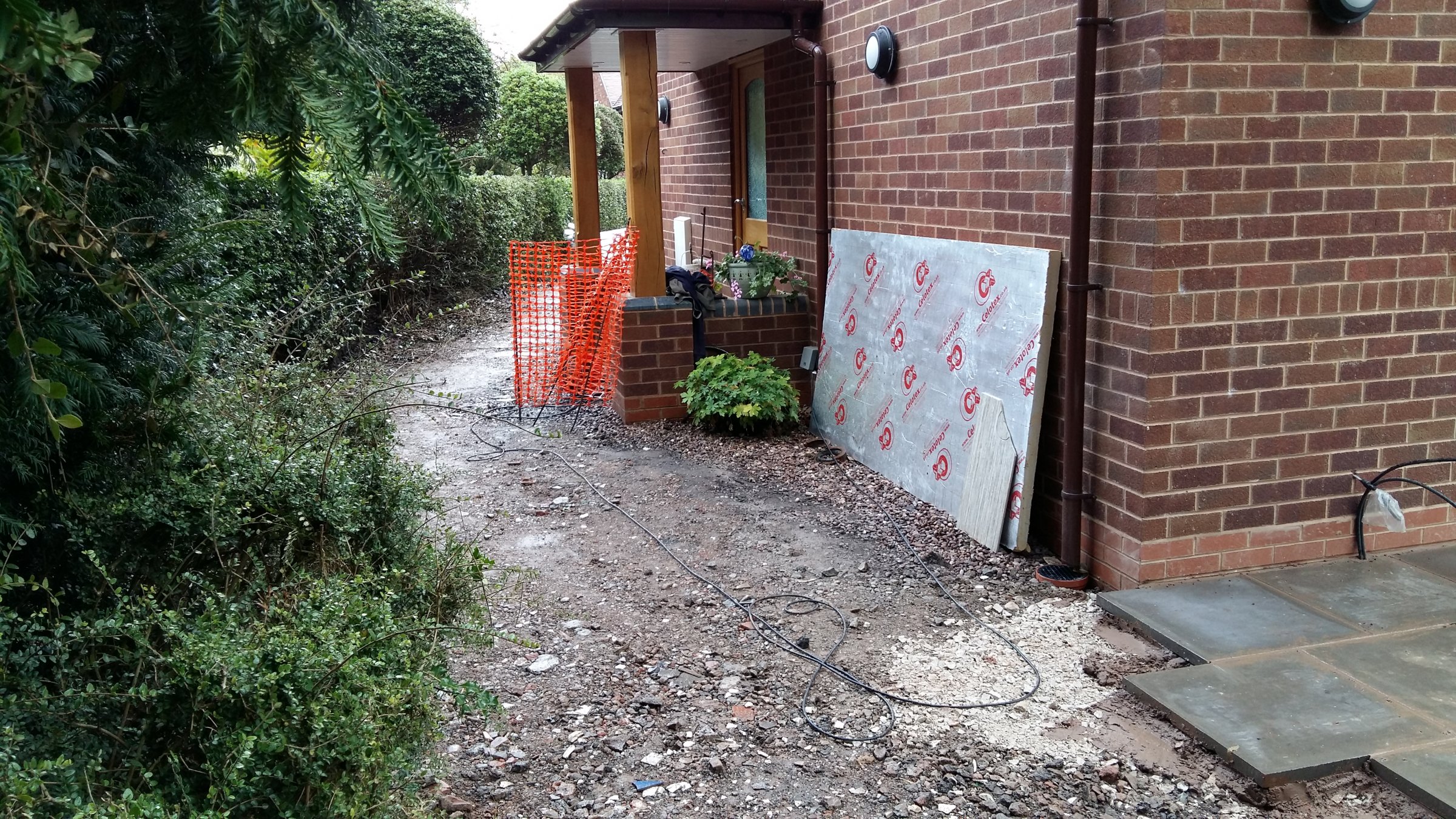

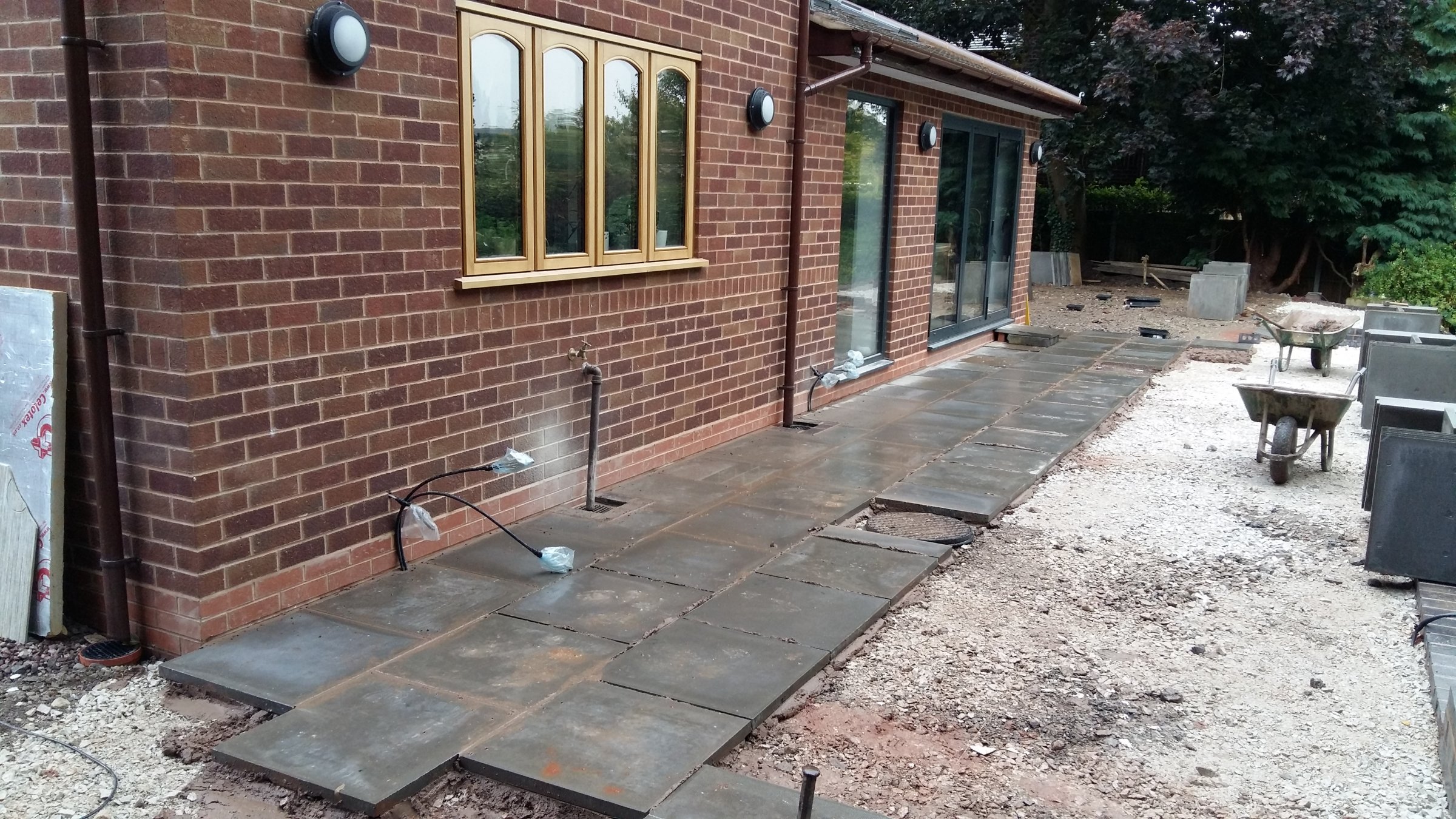

Below are some pics of my current extension build and if you can see past the mess, we are thinking of having a 12-15m wide by approx 6m deep patio (4th or 5th fence post).
