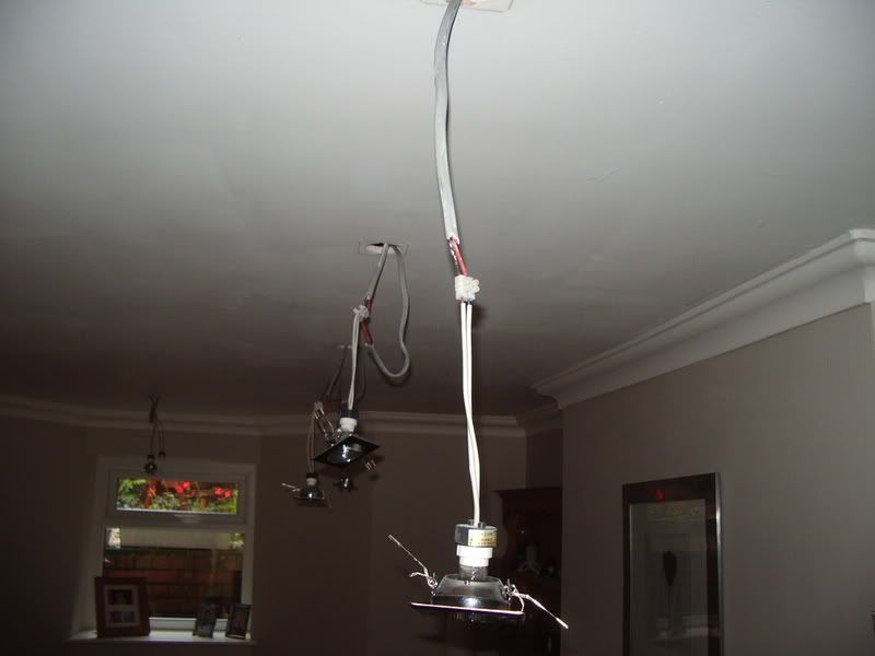

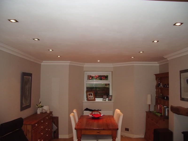

This week I was working in a cellar conversion. Downlights galore!
It was not looking too bad until I started looking a little bit futher
DL's wired in 2.5mm² T&E with the CPCs cut off, and exposed connections.

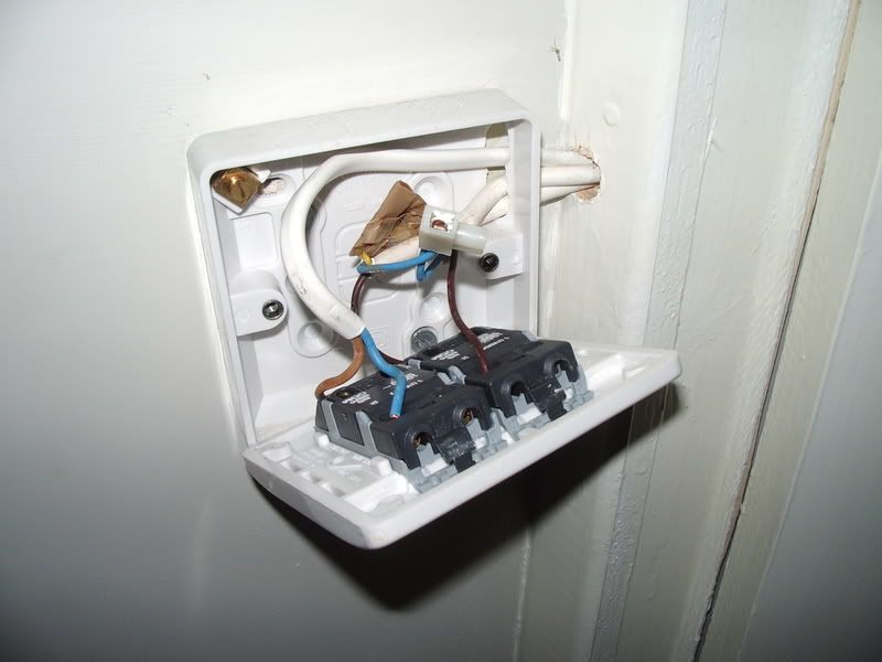

Light switches wired in 0.5mm² flex
That switch was supplied from this socket

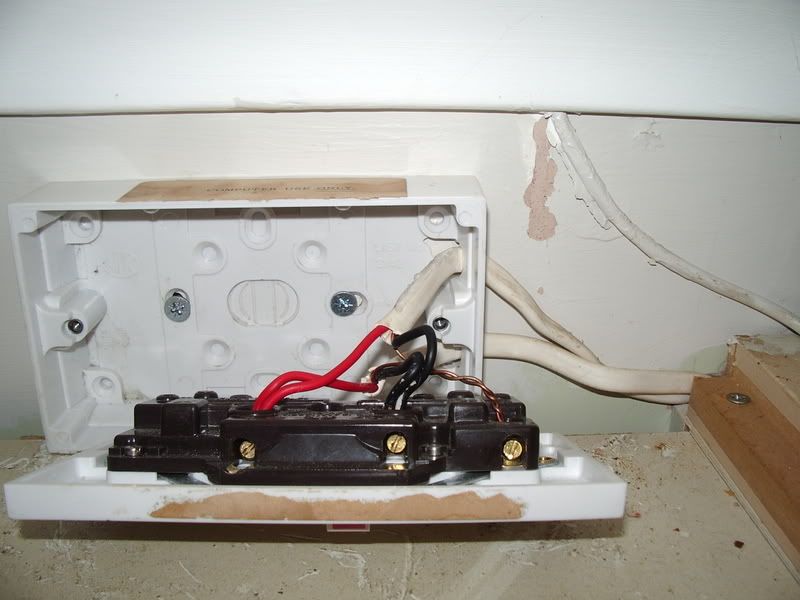

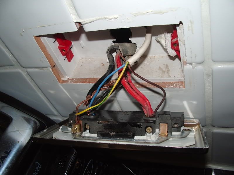

It is a 6.0mm² (former cooker supply) on a BS3036 fuse. Spurred from it is the 0.5mm² lighting supply, and three twin sockets wired in 1.0mm² (all in the kitchen)
The 6.0mm² neutral fell out of the socket as I eased it away from the wall.

Chivers7 said:
:eek: nice to see at least one bit of Earth sleeving used
That's a corded cable with factory earth sheath- There's no earth sleeving other than that.
Chri5 said:
:oops: oh yeah...is that a bit of kitchen towel in the backbox as well?
