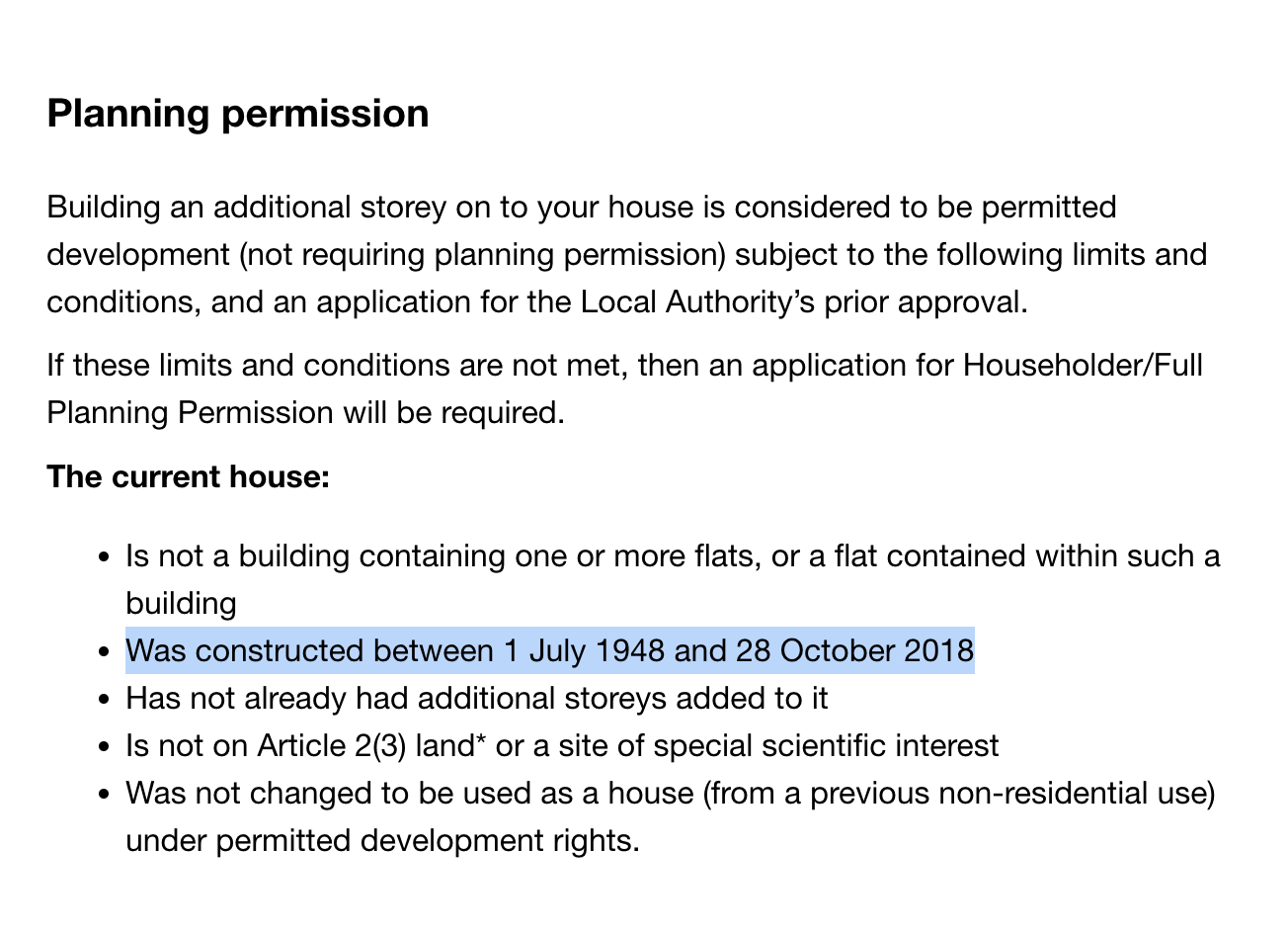

I assumed I didn't have PD rights as the planning portal says the following:
Have I got this wrong/ misunderstanding that? I assumed as the house is Edwardian I didn't have PD rights for extra stories.
Does that text you quote just relate to additional storeys?
PD rights apply to relevent properties built after 1/7/48 or existing properties as they stood on that date.
My advice is apply for pp to raise the ridge and add dormers to each property. This will need two applications. The LPA may put a condition that both must be completed at the same time but I don't think this would be enforceable and you could get it removed at appeal. But, then again, they may not put on a condition.
PS. The 1948-2018 date isn't relevant to the class B of Part 1 - it probably refers to class AA or something?

And yeah what I sent was specifically about adding additional stories, in reply to what @^woody^ said:
The fact that you could put two storeys on it under PD, and make it look completely out of place may sway a planner to consider a raise of a ridge something that would be more agreeable.
The link I was looking at says these specific rights don't apply for my house, so I wouldn't be able to use this to sway planners.
